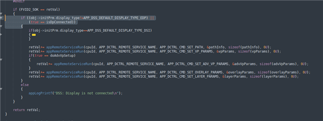

    [MCU2_0]    322.879838 s: DSS: Display is not connected
    [MCU2_0]    322.879873 s: DSS: Init ... Done !!!
