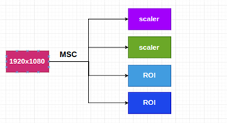

Hi experts,
SDK8.6
camera image:1920x1536
crop1 node:1280x800
MscScale node:1560x1280
We want to achieve the above Crop + MscScale results with one operation.
What node should we use? What CMD should we use?
Looking forward to your reply,Thanks
Barry
  • Hi Barry,
    You need not use any node for the crop operation. You just have to modify the pointer location of the image before sending the same into the MSC node.
    Nikhil
  • Hi Nikhil,
    Thank you for your prompt reply.
    1. We want to let the scale do the crop operation. So how should we add crop to the MSC scale?
    YOU:You need not use any node for the crop operation. You just have to modify the pointer location of the image before sending the same into the MSC node.
    2. We can achieve ROI by modifying the crop, but who will do the modification you mentioned? Will this process generate consumption load? Thank you.
    Looking forward to your reply.
    Barry
  • Hi Barry,
    You can refer to the crop implementation of the display node and try the same with the MSC node.
    The target implementation for DSS node can be found in vx_display_target.c
    Here you can follow the macro TIVX_DISPLAY_CROP_PARAMS and see how using these crop parameters offset recalculation occurs using the API tivxDisplayCalcOffset() in the process callback.
    Nikhil

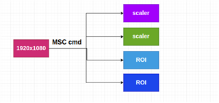

  • Hi Nikhil,
    1.OK, our ultimate goal is that an MSC CMD can complete the output of ROI+Scale. Can you send me the specific implementation method?
    We don't see this CMD, so try to add msc crop on the scale node. The question I have is how does MSC crop support image input and get image output? Can you give us some code to guide us?
    Hope to get your help. Thanks.

  • Hi Nikhil,
    you:but now I see that you want the cropped image and scaled image separately from the input camera image.
      Your understanding is correct. We are using app_multi_cam to add this requirement.
    I want an MSC CMD to complete one input image and 4 output images (2 ROI + 2 scales).

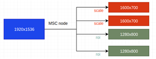

  • Hi Nikhil,
    Thanks for the reply.
    YOU: I wanted to know if your usecase is just cropping the input image or is scaling the input image first and then cropping it?
     input image cropping and scaling at the same time
    Our requirement is that one MSC node can simultaneously output 2 ROIs (1280x800) + 2 scales (1600x700).
    Are there any nodes that have implemented this function? If not,
    How to achieve the output of 2 ROIs in scale node? ( This is done so that the scale node outputs 2 ROIs + 2 scales) Can you send me a patch?
    I hope this reply is clear, looking forward to your reply.
    Ok, if you are not scaling for ROI, then my suggestion would be to get the 2 scaled outputs using MSC node and do not use MSC node for cropping.
    You can directly send the input image and modify the pointer location before feeding the ROI to the next node.
    May I know if you see any issue with the above approach?
    Nikhil

  • Hi Nikhil,
    I have output the ROI and scale via tivxVpacMscScaleNode.
    Now I have a question that I need your help to confirm:
    1.Can tivxVpacMscScaleNode support mosaic splicing function?
    2.What do the two CMDs TIVX_VPAC_MSC_CMD_SET_INPUT_PARAMS and TIVX_VPAC_MSC_CMD_SET_OUTPUT_PARAMS in tivxVpacMscScaleControl do?
    Anxiously waiting for your reply, thank you.
    Sorry for the delay in response due to the holidays in India.
    No, this node would not do mosaic function. This node would just do scaling down of the inputs.
    However, you can use tivxImgMosaicNode() to mosaic a list of images. This internally uses the MSC HWA to perform mosaicing.
    You can find this used in the vision_apps multicam demo in vision_apps/apps/basic_demos/app_multi_cam/main.c
    You can find the information about these commands in the below link
    TI J721E Imaging User Guide: TI VPAC MSC (Multi-scaler) Kernel APIs
    Nikhil
