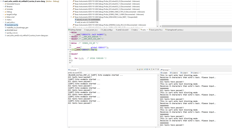

    I am currently working on a UART loopback test, where I am sending data from the TX pin of the MCU UART to the RX pin of the same UART. I executed the sample UART echo example successfully, and I saw the expected message in the UART console:
    "This is uart echo test blocking mode Receives 8 characters then echo's back. Please input.." 12345678 All tests have passed!!

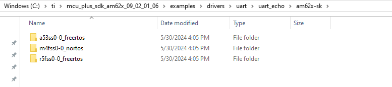

    Also, the example of GPIO LED blink works well for almost all the MCU header pins except UART pins.
    I'm working on the example of uart_echo application for the m4fss0-0_nortos.

  • Hello Abdeltif,
    I ran this on my setup and I am also not seeing any signals on the logic analyzer. I think because this is happening at the SoC level, hence we are not seeing any values while probing. Can you try a different UART pin? Like a main domain UART will also do.
