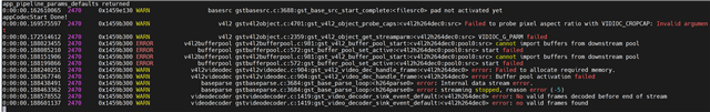

  • Hi experts,
    I tested the Gstreamer code on the command line, which was also problematic, as shown below:

  • Hi Xin,
    The "unclassified data detected" print that you are seeing is just a warning. Nothing should be wrong with the decoder.
    However, I recommend switching to the 9.2 SDK version. Encoding is broken for the TDA4VM 9.1 release (FAQ).
    Sarabesh S.

  • Hi Xin,
    Unfortunately there has yet to be one released. The fix was made in the 9.2 SDK. Please make the transition to the 9.2 release if possible. SDK 10.0 is being released soon so efforts to back-port may not be possible.
    Sarabesh S.
  • Hi Sarabesh,
    What is the reason for the following error when decoding?
    VX_ZONE_ERROR:[tivxReferenceImportHandle:1589] [Entry 1] Memory size mis-match: Expecting [3133440] but given [2088960]

       414.190365 s:  VX_ZONE_ERROR:[tivxReferenceImportHandle:1589] [Entry 1] Memory size mis-match: Expecting [3133440] but given [2088960]
    When I switched the decoded h264 file and set GST_DEBUG=4, I encountered the following problems:
    root@j721e-evm:/opt/vision_apps/test_decode# ./test_decode.sh

    0:00:00.477774180  1527      0x3a33b00 ERROR         v4l2bufferpool gstv4l2bufferpool.c:981:gst_v4l2_buffer_pool_start:<v4l2h264dec0:pool0:src> cannot import buffers from downstream pool
    0:00:00.477832864  1527      0x3a33b00 ERROR             bufferpool gstbufferpool.c:572:gst_buffer_pool_set_active:<v4l2h264dec0:pool0:src> start failed
    0:00:00.477897474  1527      0x3a33b00 ERROR         v4l2bufferpool gstv4l2bufferpool.c:981:gst_v4l2_buffer_pool_start:<v4l2h264dec0:pool0:src> cannot import buffers from downstream pool
    0:00:00.477929927  1527      0x3a33b00 ERROR             bufferpool gstbufferpool.c:572:gst_buffer_pool_set_active:<v4l2h264dec0:pool0:src> start failed
    0:00:00.477972025  1527      0x3a33b00 WARN            v4l2videodec gstv4l2videodec.c:904:gst_v4l2_video_dec_handle_frame:<v4l2h264dec0> error: Failed to allocate required memory.
    0:00:00.477998922  1527      0x3a33b00 WARN            v4l2videodec gstv4l2videodec.c:904:gst_v4l2_video_dec_handle_frame:<v4l2h264dec0> error: Buffer pool activation failed
    0:00:00.478044530  1527      0x3a33b00 INFO        GST_ERROR_SYSTEM gstelement.c:2273:gst_element_message_full_with_details:<v4l2h264dec0> posting message: Failed to allocate required memory.
    0:00:00.478180856  1527      0x3a33b00 INFO        GST_ERROR_SYSTEM gstelement.c:2300:gst_element_message_full_with_details:<v4l2h264dec0> posted error message: Failed to allocate required memory.
    0:00:00.478230574  1527      0x3a33b00 INFO            videodecoder gstvideodecoder.c:3150:gst_video_decoder_prepare_finish_frame:<v4l2h264dec0> Guessing PTS=0:00:00.000000000 for frame... DTS=0:00:00.000000000
    0:00:00.478329012  1527      0x3a33b00 WARN               baseparse gstbaseparse.c:3684:gst_base_parse_loop:<h264parse0> error: Internal data stream error.
    0:00:00.478351264  1527      0x3a33b00 WARN               baseparse gstbaseparse.c:3684:gst_base_parse_loop:<h264parse0> error: streaming stopped, reason error (-5)
    0:00:00.478392497  1527      0x3a33b00 INFO        GST_ERROR_SYSTEM gstelement.c:2273:gst_element_message_full_with_details:<h264parse0> posting message: Internal data stream error.
    0:00:00.478424894  1527      0x3a33b00 INFO        GST_ERROR_SYSTEM gstelement.c:2300:gst_element_message_full_with_details:<h264parse0> posted error message: Internal data stream error.
    0:00:00.478513021  1527      0x3a33b00 WARN            videodecoder gstvideodecoder.c:1419:gst_video_decoder_sink_event_default:<v4l2h264dec0> error: No valid frames decoded before end of stream
    0:00:00.478532257  1527      0x3a33b00 WARN            videodecoder gstvideodecoder.c:1419:gst_video_decoder_sink_event_default:<v4l2h264dec0> error: no valid frames found
    0:00:00.478558199  1527      0x3a33b00 INFO        GST_ERROR_SYSTEM gstelement.c:2273:gst_element_message_full_with_details:<v4l2h264dec0> posting message: No valid frames decoded before end of stream
    0:00:00.478585736  1527      0x3a33b00 INFO        GST_ERROR_SYSTEM gstelement.c:2300:gst_element_message_full_with_details:<v4l2h264dec0> posted error message: No valid frames decoded before end of stream

  • Hi Xin,
    Is this still on the 9.1 SDK? I know in the Linux 9.1 SDK there are memory allocation issues as highlighted in the FAQ from my first response. This is likely still the case for Linux+RTOS (AKA Vision Apps) as well. Could you try this on 9.0 or 9.2 and see if the problem still persists?
    Sarabesh S.
  • Hi Saeabesh,
    I tested the version 9.2, and there were no problems with the encoding, but there were problems with the decoding.
    Xin
    Could you please share what problems you are seeing? What pipeline or demo are you running? Are you able to test decode in just the Linux SDK or do you need Vision Apps (AKA Linux+RTOS)?
    Sarabesh S.
  • Hi Sarabesh,
    I used linux+rtos mode, using the same interface as in the codec demo in vision Apps. When using only the Linux sdk, it can be decoded by command in the terminal. In my case, I got the following error:
    The detailed log is as follows:

    0:00:00.162610065  2470     0x1459e130 WARN                 basesrc gstbasesrc.c:3688:gst_base_src_start_complete:<filesrc0> pad not activated yet
    appCodecStart Done!
    0:00:00.169575597  2470     0x1459b300 WARN                    v4l2 gstv4l2object.c:4701:gst_v4l2_object_probe_caps:<v4l2h264dec0:src> Failed to probe pixel aspect ratio with VIDIOC_CROPCAP: Invalid argument
    0:00:00.172514612  2470     0x1459b300 WARN                    v4l2 gstv4l2object.c:2359:gst_v4l2_object_get_streamparm:<v4l2h264dec0:src> VIDIOC_G_PARM failed
    0:00:00.188023455  2470     0x1459b300 ERROR         v4l2bufferpool gstv4l2bufferpool.c:981:gst_v4l2_buffer_pool_start:<v4l2h264dec0:pool0:src> cannot import buffers from downstream pool
    0:00:00.188085210  2470     0x1459b300 ERROR             bufferpool gstbufferpool.c:572:gst_buffer_pool_set_active:<v4l2h264dec0:pool0:src> start failed
    0:00:00.188151906  2470     0x1459b300 ERROR         v4l2bufferpool gstv4l2bufferpool.c:981:gst_v4l2_buffer_pool_start:<v4l2h264dec0:pool0:src> cannot import buffers from downstream pool
    0:00:00.188199866  2470     0x1459b300 ERROR             bufferpool gstbufferpool.c:572:gst_buffer_pool_set_active:<v4l2h264dec0:pool0:src> start failed
    0:00:00.188240251  2470     0x1459b300 WARN            v4l2videodec gstv4l2videodec.c:904:gst_v4l2_video_dec_handle_frame:<v4l2h264dec0> error: Failed to allocate required memory.
    0:00:00.188267746  2470     0x1459b300 WARN            v4l2videodec gstv4l2videodec.c:904:gst_v4l2_video_dec_handle_frame:<v4l2h264dec0> error: Buffer pool activation failed
    0:00:00.188438491  2470     0x1459b300 WARN               baseparse gstbaseparse.c:3684:gst_base_parse_loop:<h264parse0> error: Internal data stream error.
    0:00:00.188463362  2470     0x1459b300 WARN               baseparse gstbaseparse.c:3684:gst_base_parse_loop:<h264parse0> error: streaming stopped, reason error (-5)
    0:00:00.188578552  2470     0x1459b300 WARN            videodecoder gstvideodecoder.c:1419:gst_video_decoder_sink_event_default:<v4l2h264dec0> error: No valid frames decoded before end of stream
    0:00:00.188601137  2470     0x1459b300 WARN            videodecoder gstvideodecoder.c:1419:gst_video_decoder_sink_event_default:<v4l2h264dec0> error: no valid frames found
    ^C

    0:00:00.506841505  1879      0x28c7f60 ERROR         v4l2bufferpool gstv4l2bufferpool.c:981:gst_v4l2_buffer_pool_start:<v4l2h264dec0:pool0:src> cannot import buffers from downstream pool
    0:00:00.506901458  1879      0x28c7f60 ERROR             bufferpool gstbufferpool.c:572:gst_buffer_pool_set_active:<v4l2h264dec0:pool0:src> start failed
    0:00:00.506947235  1879      0x28c7f60 ERROR         v4l2bufferpool gstv4l2bufferpool.c:981:gst_v4l2_buffer_pool_start:<v4l2h264dec0:pool0:src> cannot import buffers from downstream pool
    0:00:00.506965091  1879      0x28c7f60 ERROR             bufferpool gstbufferpool.c:572:gst_buffer_pool_set_active:<v4l2h264dec0:pool0:src> start failed
    0:00:00.506997783  1879      0x28c7f60 WARN            v4l2videodec gstv4l2videodec.c:904:gst_v4l2_video_dec_handle_frame:<v4l2h264dec0> error: Failed to allocate required memory.
    0:00:00.507017454  1879      0x28c7f60 WARN            v4l2videodec gstv4l2videodec.c:904:gst_v4l2_video_dec_handle_frame:<v4l2h264dec0> error: Buffer pool activation failed
    0:00:00.507057976  1879      0x28c7f60 INFO        GST_ERROR_SYSTEM gstelement.c:2273:gst_element_message_full_with_details:<v4l2h264dec0> posting message: Failed to allocate required memory.
    0:00:00.507135415  1879      0x28c7f60 INFO        GST_ERROR_SYSTEM gstelement.c:2300:gst_element_message_full_with_details:<v4l2h264dec0> posted error message: Failed to allocate required memory.
    0:00:00.507170332  1879      0x28c7f60 INFO            videodecoder gstvideodecoder.c:3150:gst_video_decoder_prepare_finish_frame:<v4l2h264dec0> Guessing PTS=0:00:00.000000000 for frame... DTS=0:00:00.000000000
    0:00:00.507295524  1879      0x28c7f60 WARN               baseparse gstbaseparse.c:3684:gst_base_parse_loop:<h264parse0> error: Internal data stream error.
    0:00:00.507321560  1879      0x28c7f60 WARN               baseparse gstbaseparse.c:3684:gst_base_parse_loop:<h264parse0> error: streaming stopped, reason error (-5)
    0:00:00.507363008  1879      0x28c7f60 INFO        GST_ERROR_SYSTEM gstelement.c:2273:gst_element_message_full_with_details:<h264parse0> posting message: Internal data stream error.
    0:00:00.507395654  1879      0x28c7f60 INFO        GST_ERROR_SYSTEM gstelement.c:2300:gst_element_message_full_with_details:<h264parse0> posted error message: Internal data stream error.
    0:00:00.507482059  1879      0x28c7f60 WARN            videodecoder gstvideodecoder.c:1419:gst_video_decoder_sink_event_default:<v4l2h264dec0> error: No valid frames decoded before end of stream
    0:00:00.507501490  1879      0x28c7f60 WARN            videodecoder gstvideodecoder.c:1419:gst_video_decoder_sink_event_default:<v4l2h264dec0> error: no valid frames found
    0:00:00.507526776  1879      0x28c7f60 INFO        GST_ERROR_SYSTEM gstelement.c:2273:gst_element_message_full_with_details:<v4l2h264dec0> posting message: No valid frames decoded before end of stream
    0:00:00.507552698  1879      0x28c7f60 INFO        GST_ERROR_SYSTEM gstelement.c:2300:gst_element_message_full_with_details:<v4l2h264dec0> posted error message: No valid frames decoded before end of stream

  • Hi Sarabesh,
    Yes, I see this problem on 9.2 SDK with decoding. Encoding on 9.2 is successful.
    I test the following two command,They're all okay,
    gst-launch-1.0 filesrc location=/opt/vision_apps/test_data/psdkra/app_multi_cam_codec/TI_Custom_1920x1080_5secs.264 ! h264parse ! v4l2h264dec ! video/x-raw,format=NV12 ! fakesink
    gst-launch-1.0 filesrc location=/opt/vision_apps/test_decode/test_data/psdkra/app_multi_cam_codec/TI_Custom_1920x1080_5secs.264 ! h264parse ! v4l2h264dec ! video/x-raw,format=NV12 ! filesink location=/opt/vision_apps/test_encode/output123.yuv
    root@j721e-evm:~# gst-launch-1.0 filesrc location=/opt/vision_apps/test_decode/test_data/psdkra/app_multi_cam_codec/TI_Custom_1920x1080_5secs.264 ! h264parse ! v4l2h264dec ! video/x-raw,format=NV12 ! filesink location=/opt/vision_apps/test_encode/output123.yuv
    Setting pipeline to PAUSED ...
    Pipeline is PREROLLING ...

    Xin
  • Hi Xin,
    Ok I will run some tests on 9.2 SDK to replicate the error. Thank you for your patience. I will likely respond tomorrow or early next week.
    BR,
    Sarabesh S.
  • Hi Sarabesh,
    Is the decoding problem solved? Is there any further progress?
    xin
    Not yet, haven't gotten a chance to test this yet. Bandwidth has been limited. Will update you soon on my findings.
    Sarabesh S.
  • Hi Xin,
    Could you try with a pipeline like this:
    • gst-launch-1.0 filesrc location=<input_stream> ! queue ! h264parse ! v4l2h264dec ! videoconvert ! video/x-raw,format=NV12 ! filesink location=<output_file>
    I was able to produce a successful decode in the 9.2 SDK
    BR,
    Sarabesh S.
