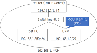

I am checking the communication in the following environment.
EVM:J7200XSOMXEVM + J721EXCP01EVM
SDK:PROCESSOR-SDK-LINUX-RT-J7200
VER:09.01.00.07
BOOT Image:prebuilt-images内のtiboot3.bin,tispl.bin,u-boot.img
DeviceTree:k3-j7200-common-proc-board.dtb
FileSystem:tisdk-default-image-j7200-evm

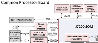

I am experiencing the following issue with the Ethernet port (MCU_RGMII1) on connector J35 of the EVM. Could you please give me some advice on how to resolve this issue?
  • When the communication speed is set to 1000Mbps, communication is not possible.

Linux (100Mbps) : While maintaining the network environment, I changed it to 100Mbps using ethtool and ran it again.
root@j7200-evm:~# ethtool -s eth0 speed 100 duplex full autoneg off

  • When the communication speed is set to 100Mbps, communication is possible but not stable (frequent CRC errors occur).
When TFTP communication was performed at 100Mbps in u-boot, a timeout occurred.

On Linux, when I ran netperf and checked for CRC errors before and after, I found a large number of errors.

    All of these are CRC errors could point to some issues with the link.
    So one end of the link is the MCU_RGMII port of the EVM. What is the other end connected to?
    Are you seeing the same results even if you change the EVM?

    The network configuration is shown below.
    We only have one J7200XSOMXEVM , so we can't check it on another J7200XSOMXEVM .
    However, when I checked communication with AM68-SK on the same network, it worked normally.

    It changes some configuration in the phy which is ususally not required for the DP83867 phy (the RGMII phy used on EVM), but is used with other TI phy's in some cases. I do not know how this exactly affects the phy. I'll find that out and let you know by next week.
    This changes the "IO_IMPEDANCE_CTRL" property in "I/O Configuration (IO_MUX_CFG), Address 0x0170" register of the phy (phy datasheet).
    This means that there might some issue with a resistor on the EVM. This has to be investigated separately. Please create a ticket if you want to investigate the hardware issue.
    Tanmay
