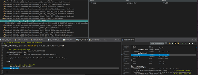

I am trying to make working the SBL boot on my board. I have followed the steps from this link(Booting lateapps via MMCSD): https://software-dl.ti.com/jacinto7/esd/processor-sdk-rtos-jacinto7/09_01_00_06/exports/docs/pdk_jacinto_09_01_00_22/docs/userguide/jacinto/boot/boot_app.html
However I am facing issue whit booting on MCU R5F:
Sciclient_procBootReleaseProcessor, ProcId 0x2...
Sciclient_procBootReleaseProcessor, ProcId 0x1...
Starting Sciserver..... PASSED
MCU R5F App started at 3295569 usecs
Board_control failed to configure RMII pins
Board_control failed to configure CPSW9G MDIO mux
And also using JTAG debugger (loading the sbl_boot_app_mmcsd_j721e_evm_mcu1_0_freertos_TestApp_release) the following picture appears:
