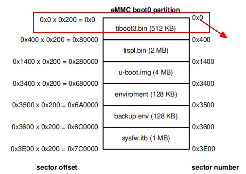

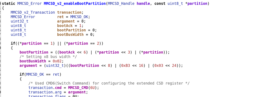

Hi, TI experts,
We want to boot from emmc boot0 partition.
but i find it not work.
i flash SBL image to emmc boot0, the offset is 0x0.
i see this picture on TDA4VM docs. Is there anything update on TDA4VE?
Is there anytings to modify if i change bootmode from ospi to emmcboot0?
i am sure i build SBL with emmcboot0 mode.
Thanks!
