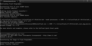

After flashing uart_j721s2_evm_flash_programmer_release.tiimage on custom board with j721s2, I can't transfer entirely sbl_cust_img_mcu1_0_release.tiimage.
The transfer blocks after completion of header transfer.
I suppose the problem is related to UART flash programmer, which is built for j721s2_evm.
Could you tell me what to update for compatibility with TDA4VE-Q1?
