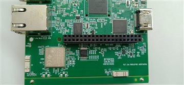

Thanks for your response. We are currently facing an issue with wlan0. Although wlan0 is up, we are not receiving any network advertisements, which suggests that it might not be properly connecting to the device.please find the schematic of the IC we've used. suggest a solution for this
    Can you please provide more details on the issue? What do you mean by you are not receiving "network advertisements"? Are you issuing "iw wlan0 scan"? Can you demonstrate with command line logs? Which Processor SDK version are you using? Is this a custom board or AM62 SK?
    Thank you for your response. We are using the Processor-SDK-AM62X on our custom board and are trying to load the latest default image. Here is the link to the image we are using
    TI SDK Default Image for AM62xx EVM.

    I
    When using ifconfig wlan0 up, the Wi-Fi interface activates, but we cannot access the network from any devices, nor can we see the Wi-Fi network when it is enabled. We have configured the Wi-Fi credentials, but it still doesn't work. hence iwconfig command is also not working.
    How can we resolve this issues

    iwlist is deprecated command. Please try 'iw wlan0 scan'. Do you have antenna connected?
    Hi
      Thanks for your response. yes we connected chip antennas .

    Thank you for your response. We’re unable to locate wlan0 using the ifconfig command. Could you please suggest a solution to address this?
  • Hi Vaishnavi,
    Since you were able to scan with 'iw wlan0 scan' as shown above, then wlan0 interface must be up also.
    Can you show please output of 'ifconfig -a' and 'dmesg'?
    Thank you for your response. I have shared the requested codes with you. After enabling wlan0, I am unable to access Wi-Fi. It seems that the AM62x processor should automatically enable Wi-Fi upon activation, but this is not happening. I have also added the wificfg file, but the issue persists. Could you please suggest a way to resolve this?

  • It seems that the AM62x processor should automatically enable Wi-Fi upon activation, but this is not happening.
    This feature has been deprecated in AM62x SDK, so that is why it is not working. In order to connect to a WiFi network, please follow these steps:
    cd /usr/share/wl18xx/
    ./sta_start.sh
    ./sta_connect-ex.sh <SSID Ex:abc> WPA-PSK <password Ex:12345678>
    udhcpc -i wlan0
    The logs you provided show no issue with wlan0 interface. Everything seems to be working well. It just seems there was misunderstanding with wificfg and automatically connecting to network.
  • Hello
      Thanks for your response. I resolved  my issues using above commands. How to enable the  bluetooth in am62x processor. suggest some steps or commands.
