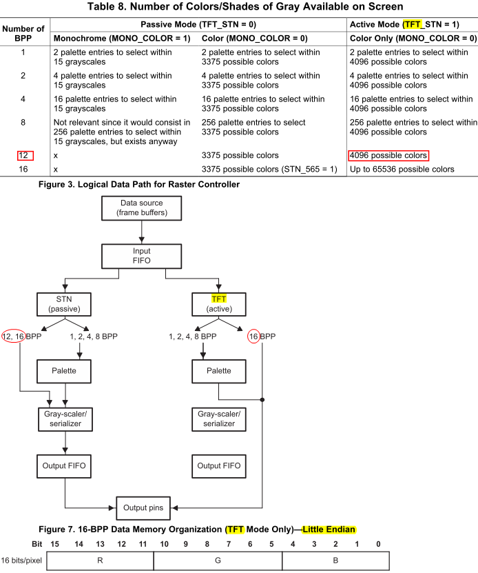

I would like to ask a question on AM1808 LCD.
Is 12-bit LCD output supported in TFT mode? In AM1808 LCDC manual:
Table 8
Figure 3
(my interpretation)
Figure 7
(my interpretation)
So the vote is 1:2, it is quite unclear that whether 12-bit output is supported or not under TFT mode.
Could anyone confirm on this?
