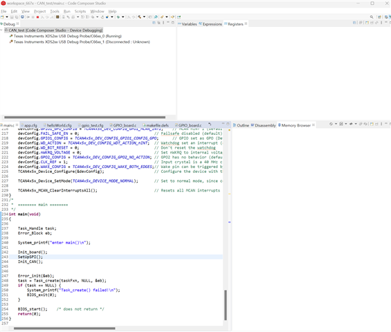

When I start debugging, nothing happens. It doesn't break in main. Please tell me why this phenomenon occurs and how to solve it.

In the meanwhile, please check if you are using the debug version of the binaries for your CCS debug.

Please provide the following details.
1. What is the name of the software you use?
2. Is it TI-offered?
3. If yes, please mention the name and version details.
For C667x, the latest working software is "Processor SDK 6.3".
I have tested the examples of this software multiple times. I am able to put break points and debug successfully.
