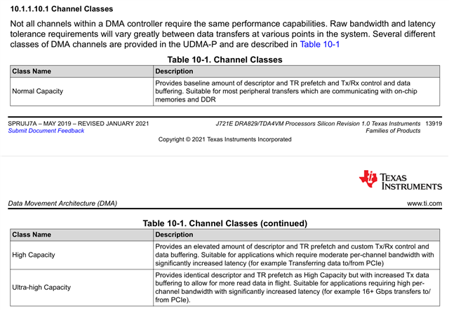

  • Hi Lei, Brijesh,
    Customer fixed this issue by change the UDMA channel from HC to UHC channel. customer issue is when they just run the AVM app (partional function), it will not stuck, but they run the parking in the real car (full functional) it will stuck at udma callback. now Car oem want Neusoft give some detail explanation and analysis, so Brijesh we need your help give some comments about this. From TRM I think this may fixed by the more capacity in UHC. do you have some additional explanation about this?
    BR,
    Biao
  • Hi Biao,
    Strange, even in high load cases, UDMA should still work, it might be delayed, but it should still finish, so if you have timeout on the callback, you might need to increase the timeout, but the callback should still come..
    For High capacity channels, as the name suggests, it has higher buffering, so allows cushion in case of high BW scenario.
    Brijesh
  • Hi Brijesh,
    I agree with this viewpoint, theoretically, it is indeed true. But in reality, the interrupt callback was not triggered. The data is as follows:
    We add statistics at the callback function entry (post count) and before the wait function (receive count).In theory, if the receive count is+1, then the send count is+1. Log:
    At 665s, the last frame of data was sent out with a Count of 10030, followed by an abnormal trigger and Wait entering dead state. The received Count was 10031, as shown in the red block diagram.
    After 179s (At 844s), it can be seen that the post count is still 10030. If the interrupt triggers normally, the sending Count should be 10031. And when the problem occurs, it is confirmed through the UDMA status register that the UDMA status of the last frame is normal, as shown in the yellow block diagram.

  • Hi Lei,
    Do you mean the capture is stuck? On which device are you seeing this issue? Do you see any overflow or any other error? Which SDK release are you using?
    Brijesh
  • Hi Brijesh,
    It's CSITX.
    No Error.
    For details, please refer to the log analysis.
    SDK8.6.
    BR,
    Lei
  • Hi Lei,
    I dont see CSITX getting stuck from the log. Can you please share the complete log?
    In the latest release, the only change the we did is to increate some fifo depth, can you please try with this change?
    Brijesh
  • Essentially, please add below line of code in Csitx_chCfgInit API in packages\ti\drv\csitx\src\csitx_drvInit.c file.
    #if defined (SOC_J721S2) || defined (SOC_J784S4)
    /*FifoDepth of UDMA transmit channel should be a multiple of PSI-L interface data path
    width in bytes. This parameter is adjusted according to the frame
    size for optimal performance */
    chCfgPrms->txChParams.fifoDepth = ((CSL_NAVSS_UDMAP_TX_CHANS_FDEPTH)/8U)*16U;
    #elif defined (SOC_J721E)
    chCfgPrms->txChParams.fifoDepth = ((CSL_NAVSS_UDMAP_TX_CHANS_FDEPTH)/8U)*8U;
    #endifc
