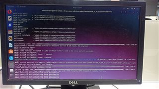

I am encountering an issue while building the Yocto image for the TI Processor SDK for the J784S4X EVM. The build fails during the do_compile task of the gcc-cross_11.4.bb recipe with the following error message:
"ERROR: Task (mc:k3r5:/home/administrator/ti-processor-sdk-linux-adas-j784s4-evm-09_02_00_05/yocto-build/sources/oe-core/meta/recipes-devtools/gcc/gcc-cross_11.4.bb:do_compile) failed with exit code '1'"
Herewith, I have attached the screenshot of the error message for your reference. We tried bitbake cleanall gcc and cleanall gcc-cross both are doesn't work.
  • Hi Suriya,
    What recipe are you trying to build?
    Jared
  • Hi Jared,
    Thank you for the reply!
    Encountered an error when executing the following command::
    "MACHINE="j784s4-evm" bitbake -k tisdk-adas-image"
    This command is part of the build steps in the "Steps to Yocto Build Image" section and recipe section is not involved in this process.
    Recipe name: gcc-cross8420.log.txt
  • Hi Suriya,
    Can you try cleaning gcc-source-11.4.0 then rebuilding?
    Jared
  • Hi Jared,
    After cleaning the gcc-source-11.4.0 command, I'm still encountering the same issue. Attached are the screenshots.
  • HI Jared ,
    we are blocked on this , we were trying to build
    We are facing issue in gcc-cross
    we tried cleanall gcc-source-11.4.0 , gcc-source-arm-11.2 and build the image again it showing the same error.
    Attached the log files please do check and get back.

    Thank for the response
     when I am building a image
    NOTE: Started PRServer with DBfile: /home/administrator/ti-processor-sdk-linux-adas-j784s4-evm-09_02_00_05/yocto-build/build/cache/prserv.sqlite3, Address: 127.0.0.1:41909, PID: 687049
    Loading cache: 100% |##########################################################################################################| Time: 0:00:01
    Loaded 9396 entries from dependency cache.
    Parsing recipes: 100% |########################################################################################################| Time: 0:00:01
    Parsing of 6326 .bb files complete (6322 cached, 4 parsed). 9400 targets, 1095 skipped, 0 masked, 0 errors.
    NOTE: Resolving any missing task queue dependencies
    Build Configuration (mc:default):
    BB_VERSION = "2.0.0"
    BUILD_SYS = "x86_64-linux"
    NATIVELSBSTRING = "ubuntu-22.04"
    TARGET_SYS = "aarch64-oe-linux"
    MACHINE = "j784s4-evm"
    DISTRO = "arago"
    DISTRO_VERSION = "2023.10"
    TUNE_FEATURES = "aarch64"
    TARGET_FPU = ""
    meta-arago-distro
    meta-arago-extras
    meta-arago-demos
    meta-arago-test = "HEAD:98f178314931635c8641d1394dfd4341b86b6be2"
    meta-qt5 = "HEAD:ae8a97f79364bed1abc297636f7933d0e35f22be"
    meta-virtualization = "HEAD:cb2bc17e96552cdfc141d27bd9f4dbd95a872846"
    meta-networking
    meta-python
    meta-oe
    meta-gnome
    meta-filesystems = "HEAD:8bb16533532b6abc2eded7d9961ab2a108fd7a5b"
    meta-ti-extras
    meta-ti-bsp = "HEAD:376a2143533c6497b4e79304eccca2a630784436"
    meta-arm
    meta-arm-toolchain = "HEAD:d7b7b6fb6c7c5545e718e44f38853d1718ce5446"
    meta = "HEAD:1b5405955c7c2579ed1f52522e2e177d0281fa33"
    meta-tisdk = "HEAD:b127f5f2a16fdc092a339939cf04c2fc92f15a34"
    meta-edgeai = "HEAD:98021388d90a6630d1185cba0e54d7c9bc3835ee"
    Build Configuration:
    TARGET_SYS = "arm-oe-eabi"
    MACHINE = "j784s4-evm-k3r5"
    DISTRO = "arago"
    TUNE_FEATURES = "arm armv7a vfp thumb callconvention-hard"
    TARGET_FPU = "hard"
    meta-arago-distro
    meta-arago-extras
    meta-arago-demos
    meta-networking
    meta-python
    meta-oe
    meta-gnome
    meta-ti-extras
    meta-arm
    Initialising tasks: 100% |#####################################################################################################| Time: 0:00:09
    Sstate summary: Wanted 80 Local 79 Mirrors 0 Missed 1 Current 4017 (98% match, 99% complete)
    NOTE: Executing Tasks
    NOTE: Tasks Summary: Attempted 10500 tasks of which 10500 didn't need to be rerun and all succeeded.
    NOTE: Writing buildhistory
    NOTE: Writing buildhistory took: 3 seconds
    the above one in sstate is not 100%
    what does sstate summary means?
    is it ok if it is 99%?
    is my generated image corrupted?
