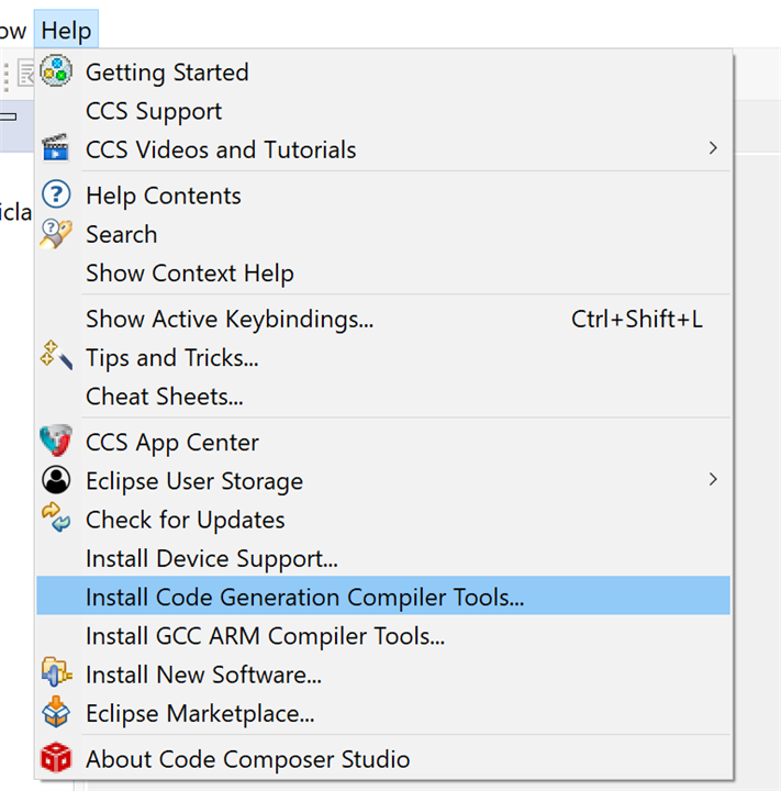

CC12.7.1 has this compiler update for new and older compilers.
Where is the equivalent on CCS Theia 1.4.1?
Would you please show us explicitly?
  • Hi Wayne,
    Please note that there are some gaps in functionality (as you noticed) between CCS Eclipse and CCS Theia. This option is not yet available in CCS Theia.
