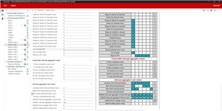

  • Hi Matthijs,
    Can you please check the TISCI_DEV_MCU_GPIOMUX_INTROUTER0(i.e. type: 320) entries in the rm-cfg.yaml file present at path ${SDK}/board-support/ti-u-boot-<version>/board/ti/am64x?
    From the above image I can see that the TISCI_DEV_MCU_GPIOMUX_INTROUTER0 is only allocated to host id 30 and 12 which belongs to M4_0 and A53_2 respectively. You will need to allocate the interrupt router to R5F core before configuring it.

  • Hi Tushar,
    Really appreciate the quick follow-up. Thanks for that.

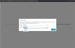

    I am following the instructions you linked and am running sysconfig from the "k3-resource-partitioning"-folder. Starting this and loading the "k3-resource-partitioning/out/am64x-evm.syscfg presented me with a menu with a "Variant" option.
    What does this "Variant" refer to? The AM64x user guide has a section on "Revisions and Assembly Variants" but does not mention a D, E, or F label.
    I did find in the Technical reference manual under "Revision history" mention "Changes from July 18, 2023 to October 31, 2023 (from Revision G (July 2023) to Revision H (October 2023))"
    I am going with the default setting here but is there is a "more correct" variant to select here?
    Also, is this default/initial sysconfig that I am loading also the one my "out of the box" bootloader was built with? Or is there a chance at regressions in other settings if I build a new uboot bin file with this change?
    Finally, I am unsure how to make the relevant configuration change you describe. I did find the setting "MCU GPIO Interrupt Router Count" in the tool. But should I give the R5F core access to it by adding a "Resource Sharing" module/instance from either the M4_0 or A53_2 core? Or should I add increment the "MCU GPIO Interrupt Router Count" setting under the MAIN_0_R5_1 tab? as shown here:
    Note that I also changed the router count in the other cores from 4 to 2. As not doing that while increasing the router count on the 0_R5_1 core caused gave the error:

  • Hi Matthijs,
    To get the above information please refer to the section Device Naming Convention device specific datasheet.

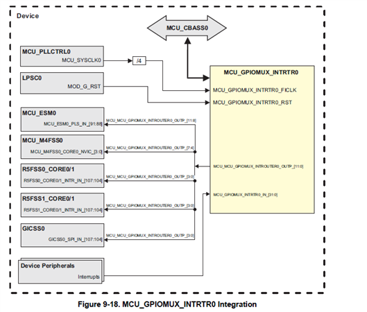

    From the TRM, I can see that the MCU_GPIOMUX_ROUTER [0:3] is connected to both the A53 and R5F core.
    So you can share the MCU_GPIOMUX_ROUTER between both A53 and R5F.

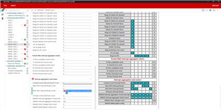

    Please refer below image.
    To share the resources, please do below changes in resource partition.
    Go to resource sharing, add a new sharing option and configure it according to the below parameters.
    Save the rm-cfg.yaml file and follow the steps mentioned in the above FAQ.

  • Hi Tushar,
    I did save the new .yaml-file as instructed. Appreciate the screenshots.
