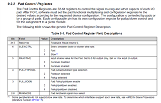

  • With respect to pinmux configuration
    regVal=0x10;
    HW_WR_REG32((SOC_CONTROL_REGS+PIN_ECAP0_IN_PWM0_OUT), regVal);// mode 0 _ primary mode
    this is the setting i have made.
    The ECCTL1 and ECCTL2 registers have been set to 0x01FF and 0x0096, respectively.
    My query is regarding the necessity of enabling interrupts for capturing timestamps in the capture registers. Is it possible to directly view the captured timestamp without enabling the interrupt?
    Additionally, if the interrupt must be enabled in the ECAP_ECEINT register, I am unsure where to add the ISR for this interrupt. Could you please provide guidance on this?
    i tried with enabling interrupt in ECAP_ECEINT for all capture events still am not able to see the values in cap1-4 registers
  • Hello Subhash,
    your pinmux looks wrong to me.
    The muxmode = 0 looks fine to route the pin to signal "eCAP0_in_PWM0_out". However, you are setting RXACTIVE = 0 = "receiver disabled", when I would expect it needs to be equal to 1.
    From the AM335x technical reference manual (TRM):
    I am not able to comment on ISR, etc. The best I can do is point you to the TRM section PWMSS > eCAP module > Functional Description for more details about how the hardware works.
    Off the top of my head, I would expect that the captured timestamp will happen regardless of whether interrupts are enabled or not.
    This is about as far as I can take you. If updating the pinmux settings does not help, I can send you over to the hardware guy to comment.
    Nick
  • Apologies for the delay; due to the Independence Day holiday and the following weekend, I was unable to check earlier.
    Today, I reconfigured the PINMUX settings and can now see data in the capture registers.
    Thank you so much for your support, and a special thanks to the TI support team and Nick Saulnier.
