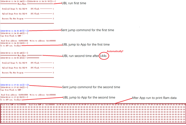

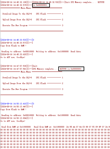

  • I would like to know what is the difference between Debug and standalone run?
    when I use XDS560V2 to debug the Boot, it can jump to App directly,
    but when it run alone, Boot need jump twice to App, and the interval between two Boots is 144 seconds.

  • The current issue is that the app needs to jump twice before it can run (determined by serial port printing)
    0x11804820 is the map file of the app
    Uint32 gAppPoint = 0x11804820;
    static void (*APPEntry)(void);
    void JumpToApp(void)
        APPEntry = (void (*)(void)) gAppPoint;
        (*APPEntry)();
    #1. Do you mean use this code can jump successfully?
    #2. if not, please help me understand how do you know need to jump twice? as this is booting from UART, if fail should hang there.
    #3. Where is your UBL running? hope it is not overlayed with app. please double check the .map file.
  • #1. Do you mean use this code can jump successfully?
          Yes, but it need to jump twice, when App running, it will print Ram data.
    UBL and App are all in SPI Flash, not from UART, only print something through UART.
  • #3. Where is your UBL running? hope it is not overlayed with app. please double check the .map file.
    UBL run in RAM 0x80000000, App run in 0x11800000, there aren`t overlapped with UBL and App.

  • Do you mean wait 144s, it automatically run to the menu again?
    seems warm reset, do you enabled watchdog?
  • Yes, UBL automatically run again after 144s
     I didn`t  enable watchdog, if disable watchdog is  default.

    Add code to read RSTYPE register to see if there is warm reset occurred.
  • XWRST is always 0x00000001, mean Power on reset.
    I print it like this:

  • I'll add one more detail, in the middle of the 144 seconds, I send a jump command, and when it reboots, it jumps directly to the app.
    It looks like, for 144 seconds, the UART is working and saved the jump command.

  • Now, I test it again, and it doesn`t need 144s to wait.
    But  UBL still need to run twice before jump to App.
    The only different is address 0x1180000 and 0x0080000 .
  • Upload the .cmd file of UBL and App to take a look.

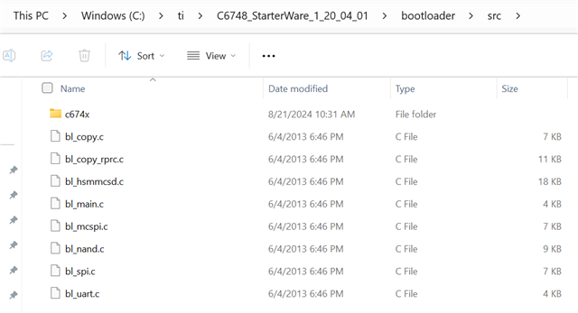

  • I am afraid the problem in your code logic, you can refer C678 starterware boot example.
    www.ti.com/.../STARTERWARE-C6748
    For a trial, combine 2 and 3 in sequence. jump to app just after load from flash.

  • We did not see you code, can't comment on your description.
    Did you look at the Starterware Boot example I mentioned above?
    **                     Global Variable Definitions
    unsigned int entryPoint = 0;
    unsigned int DspEntryPoint = 0;
    **                     Global Function Definitions
     * \brief This function initializes the system and copies the image.
     * \param  none
     * \return none
    int main(void)
        /* Configures PLL and DDR controller*/
        BlPlatformConfig();
        UARTPuts("StarterWare ", -1);
        UARTPuts(deviceType, -1);
        UARTPuts(" Boot Loader\n\r", -1);
        /* Copies application from non-volatile flash memory to RAM */
        ImageCopy();
        UARTPuts("Jumping to StarterWare Application...\r\n\n", -1);
        /* Do any post-copy config before leaving boot loader */
        BlPlatformConfigPostBoot();
        /* Giving control to the application */
        appEntry = (void (*)(void)) entryPoint;
        (*appEntry)( );
        return 0;
    This example is referred by most users without any doubt.
    You can also test it on your board.
  • Yes, the example could work correctly,
    but I can`t find the reason for my issue.
  • Thanks for your help, I resolved the issue by using the example.
    Although I couldn't find what was wrong with my code.
