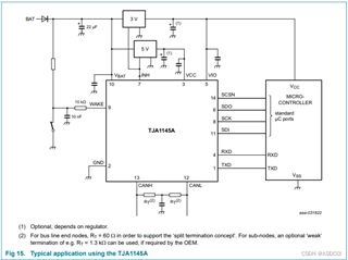

  • Hi,the previous project used 1145 plus pmic to achieve sleep and Wake up.
    This is a similar schematic and does not represent the actual project
    The principle is that the INH pin of the 1145 chip is connected to the PMIC, and the PMIC controls the output high and low levels.
    After hibernation, the INH pin of 1145 is pulled down, PMIC outputs low level, MCU is powered off and sleeps, then 1145 will detect the message on the bus, if it conforms to a specific frame, 1145 will be awakened, INH is pulled up, PMIC outputs high level, and MCU is powered on. Round and round again.
    1.Where can I find the original explanation like my comment,describe function and explain principle
    The i2c for setting PMIC in demo uses wkup i2c0 and mcu i2c0. 2.How do I know how PMIC is connected to wkup and MCU? where can I see the schematic diagram of the PMIC, including its connection with other chip pins.Is there any reference document
    Therefore, I am not clear about the functions of the PMIC module of am62p. I have seen the demo of PMIC in the latest sdk, which implements functions similar to hardware watchdog. When the watchdog makes mistakes, it will reset.
    3.Then, can PMIC be set to sleep and wake up? Is there any relationship between PMIC and low power consumption mode of DM
    You can find the schematics for SK-AM62P-LP here under "Design Files Package": https://www.ti.com/tool/SK-AM62P-LP
    PMICs are independent & not required of Low Power Modes expect for Partial I/O Mode. Partial I/O Mode requires a PMIC.
    PMICs don't have suspend/resume functionality, so they remain on during low power modes.

  • PMIC is a power control chip that supplies power to Linux and MCU, and the role of the DM firmware library running on the wkup domain is to provide a low-power interface for linux
    1. What effect does linux have on the mcu when it enters low-power mode
    2. when deep sleep, mcu will stop running, because I saw this explanation
    "MCU Only Similar to Deep Sleep, with the major distinction being that the MCU core is kept alive to run applications."
    Since the mcu program runs on sram, the ddr self-refresh will not affect the mcu after entering low power consumption, right
    Why is PMIC not associated with low power mode.Since linux is in low power mode.
    3.so what is the use of setting pmic in mcu, as a watchdog function?Is the function of the pmic just a hardware watchdog, which can be activated through a register.
    4. Can the MCU power down by setting PMIC?
    5.When linux enters low power means that linux is shut down, exit low power is to restart, or will save the data, when wake up will be recovered from the hibernation state.
    Which of these two understandings is correct?
    Since the DM firmware will be adjusting the PLLs and peripherals states, the PMIC is not required to remove the power supply to those peripherals. The schematic will show how the power is routed through the board design.
