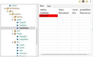

SYSBIOS: Index out of range error with using GateMutex
Part Number: SYSBIOS
Other Parts Discussed in Thread: IWR1642BOOST

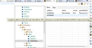

I am using BIOS version 6.73.01.01 with the TI IWR1642BOOST board. While programming the ARM core of the board, I use ti.sysbios.Gates.GateAll to protect critical sections of the code. However, in the ROV classic view of CCS, I encounter an "index out of range" error in the GateMutex section. I'm unsure why GateMutex is being displayed since I'm not using GateMutex or GateHwi. Is this expected behavior? Additionally, the GateMutex address  is shown in red, and when I hover over it, I see an "Index out of range error" message. How can I resolve this issue?
The cfg file contains the below info

Could you help me solve this. Thank you.
Gayatri
