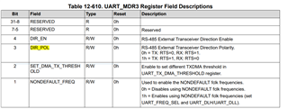

I'm trying to configure UART1 for RS485 by using 8520_omap driver and it does not support RTS pin to control automatically. I have found one more driver serial_omap and it does support for controlling RTS.
Is it possible to control RTS using 8520_omap driver? or do I need to use serial_omap?

if I need to use serial_omap for this then how I can enable it properly? If I enable it then console doesn't work I think it does not create ttyS2 e.g or something else happened.
