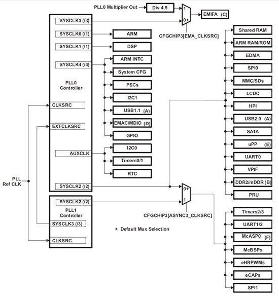

in the reference guide of the OMAP-L138 it is mentioned that the source for TBCLK is SYSCLKOUT. Since my processor is running @300MHz I thought if the fields HSPCLKDIV and CLKDIV of the TBCTL register are both set to DIVBY1 the frequency of one counter step is 300 MHz.
Now Iam observing the following: If I set the maximum period in TBPRD to 0 I measure a frequency of 75 MHz with the oscilloscope. Can you give me hint why? I expected 300MHz ...

  • Hi Steve,
    The ehrpwm peripheral is connected to SYSCLK2 coming from PLL0 or PLL1 depending upon the ASYNC3_CLKSRC field of CFGCHIP3 register. Kindly refer to Figure 7.1 (Section 7 -  device Clocking) in OMAPL138 System Reference Guide.

  • Hi Awais,
    thanks for your answer and sorry the delay. Ok the picture makes it clear. ASYNC3_CLKSRC is set to 0 and according to my PLL configuration  SYSCLK2 should be configured  to be 150 MHz. But still why is the frequency 75 MHz (I thought programming TBPRD to 0 is one step until the programmed action (TOGGLING) is applied to the output)?
    Unfortunatly since my input voltage is 1V2 and according to TIs Clocking_Check XLS it is not possible to set SYSCLK2 higher than 150MHz (PLL1) or 187,5 MHz(PLL0). Do you know any other way to achieve a PWM  frequency of 13 MHz for the output EPWM1A? I can only set it to either 15 MHz or the next lower frequency is 12.5 MHz. I think both choices are not exact enough for my application.
