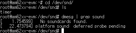

    However, i don't see the sound interface and it does not work yet.
    May you guide device tree setting for AM6254? I found dts.readme in the given driver code but i don't see this dts config reference in AM6254 SDK.
    1) My dts setting in the in previouse comment (2043.dts.txt)
    2) Below is our power on log/test log after driver is ported. (kernel_test_log.txt)
    kernel_test_log.txt
  • I also try to config dts setting as in "dts.readme" in the given driver link but the result is the same.
    Please refer to the patch and kernel log.
    try2__tas2505_readme_dts_log.txt

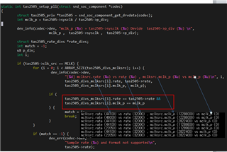

    +	struct snd_pcm_hw_params *params, struct snd_soc_dai *dai)
    +	struct snd_soc_component *codec = dai->component;
    +	struct tas2505_priv *tas2505 = snd_soc_component_get_drvdata(codec);
    +	u8 data = 0;
    +	switch (params_width(params)) {
    +	case 16:
    +		break;
    +	case 20:
    +		data = TAS2505_WORD_LEN_20BITS;
    +		break;
    +	case 24:
    +		data = TAS2505_WORD_LEN_24BITS;
    +		break;
    +	case 32:
    +		data = TAS2505_WORD_LEN_32BITS;
    +		break;
    +	default:
    +		dev_err(codec->dev, "Unsupported width %d\n",
    +			params_width(params));
    +		return -EINVAL;
    +	dev_info(codec->dev, "%s: bit width = %d\n",
    +				__func__, params_width(params));
    +	data <<= TAS2505_IFACE1_DATALEN_SHIFT;
    +	snd_soc_component_update_bits(codec, TAS2505_IFACE1,
    +		TAS2505_IFACE1_DATALEN_MASK, data);
    +	tas2505->rate = params_rate(params);
    +	tas2505->frame_size = snd_soc_params_to_frame_size(params);
    +	return tas2505_setup_pll(codec);

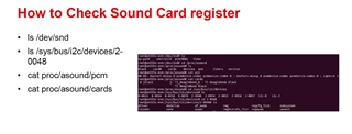

  • You can use below commands to check the Audio sound card

    root@am62xx-evm:~# ls /dev/snd/
    timer
    root@am62xx-evm:/proc/asound# ls
    cards devices pcm timers version
    root@am62xx-evm:/proc/asound# cat cards
    --- no soundcards ---
    root@am62xx-evm:/proc/asound# cat pcm
    root@am62xx-evm:/proc/asound# cat devices
    33: : timer
    root@am62xx-evm:~# ls /sys/bus/i2c/devices/1-0018/
    driver modalias name of_node power subsystem uevent
    root@am62xx-evm:~# cd /sys/bus/i2c/devices/
    root@am62xx-evm:/sys/bus/i2c/devices# ls
    0-0014 0-003f 0-0051 1-0018 1-0022 1-0068 i2c-0 i2c-1
    root@am62xx-evm:/sys/bus/i2c/devices# ls /sys/bus/i2c/devices/1-0018/
    root@am62xx-evm:/sys/bus/i2c/devices# cat /proc/asound/pcm
    root@am62xx-evm:/sys/bus/i2c/devices# cat /proc/asound/cards
    root@am62xx-evm:/sys/bus/i2c/devices# dmesg | grep tas2505
    [ 1.175849] tas2505-codec 1-0018: tas2505_i2c_probe: clock-source = BCLK

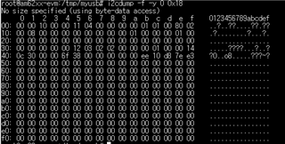

  • FYI, current it seems we have issue with i2c as well.
    This could effect the AMP device node is not shown?
    root@am62xx-evm:/sys/bus/i2c/devices# i2cdetect -y 0
    Warning: Can't use SMBus Quick Write command, will skip some addresses
    0 1 2 3 4 5 6 7 8 9 a b c d e f
    00:
    10:
    20:
    30: -- -- -- -- -- -- -- --
    40:
    50: -- UU -- -- -- -- -- -- -- -- -- -- -- -- -- --
    60:
    70:
    root@am62xx-evm:/sys/bus/i2c/devices# i2cdetect -y 1
    00:
    10:
    20:
    40:
    50: -- -- -- -- -- -- -- -- -- -- -- -- -- -- -- --
    60:
    70:
  • Hi Paul,
    The i2cdetect doesn't rely on driver, maybe is a hardware issue or an issue with system level, pls check it first.
    Kevin

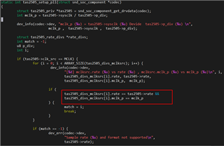

    +static int tas2505_setup_pll(struct snd_soc_component *codec)
    +	int mclk_p = tas2505->sysclk / tas2505->p_div;
    +	struct tas2505_rate_divs *rate_divs;
    +	int match = -1;
    +	u8 p_div;
    +	int i;
    +	if (tas2505->clk_src == MCLK) {
    +		for (i = 0; i < ARRAY_SIZE(tas2505_divs_mclksrc); i++) {
    +			if (
    +				tas2505_divs_mclksrc[i].rate == tas2505->rate &&
    +				tas2505_divs_mclksrc[i].mclk_p == mclk_p
    +				match = i;
    +				break;
    +		if (match == -1) {
    +				"Sample rate (%u) and format not supported\n",
    +				tas2505->rate);
    +			return -EINVAL;
    +		tas2505->rate_div_line = match;
    +		rate_divs = (struct tas2505_rate_divs *)tas2505_divs_mclksrc;
    +	} else {
    +		for (i = 0; i < ARRAY_SIZE(tas2505_divs_bclksrc); i++) {
    +			if (tas2505_divs_bclksrc[i].rate ==
    +				tas2505->rate) {
    +				match = i;
    +				break;
    +				tas2505->rate);
    +			return -EINVAL;
    +		rate_divs = (struct tas2505_rate_divs *)tas2505_divs_bclksrc;
    +	p_div = (tas2505->p_div == 8) ? 0 : tas2505->p_div;
    +	p_div <<= TAS2505_PLLPR_P_SHIFT;
    +	p_div |= rate_divs[match].pll_r;
    +	p_div |= TAS2505_PM_MASK;
    +	snd_soc_component_write(codec, TAS2505_PLLPR, p_div);
    +	snd_soc_component_write(codec, TAS2505_PLLJ,
    +		rate_divs[match].pll_j);
    +	snd_soc_component_write(codec, TAS2505_PLLDMSB,
    +		rate_divs[match].pll_d >> 8);
    +	snd_soc_component_write(codec, TAS2505_PLLDLSB,
    +		rate_divs[match].pll_d & 0xff);
    +	mdelay(15);
    +	snd_soc_component_write(codec, TAS2505_NDAC,
    +		TAS2505_PM_MASK | rate_divs[match].ndac);
    +	snd_soc_component_write(codec, TAS2505_MDAC,
    +		TAS2505_PM_MASK | rate_divs[match].mdac);
    +	snd_soc_component_write(codec, TAS2505_DOSRMSB,
    +		rate_divs[match].dosr >> 8);
    +	snd_soc_component_write(codec, TAS2505_DOSRLSB,
    +		rate_divs[match].dosr & 0xff);
    +	if (tas2505->clk_src != MCLK)
    +		snd_soc_component_update_bits(codec, TAS2505_BCLKNDIV,
    +			TAS2505_BCLKNDIV_MASK,
    +			(rate_divs[match].dosr * rate_divs[match].mdac) /
    +			tas2505->frame_size);
    +	return 0;

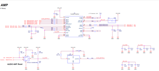

  • Hi Paul,
    I didn't see SCL & SDA connect with 3.3V pull up, the device doesn't have internal pull up, also AVDD&DVDD should be 1.8V
    Kevin

  • Hello Kevin,
    We have pull up registers and AVDD&DVDD  1.8V (we tested and confirmed 1.8v).
    Now, i will test new pin muxing below; if not work, i may reach EP team. If you have any other suggestion, please me know. Thanks.

  • You can connect device with i2ctool first, then continue to register sound card.
  • Hello Kevin
    May you detail how to proceed?
    Below is the status of source card.

  • Hello Kevin
    We found after tas2505 driver is loaded (0x18), i2c is busy.
    Is it normal? If not, may you suggest? Thanks.

  • I think from the i2cdetect result, the i2c of tas2505 is not working, please check with Oscilloscope, maybe not an issue from SW side.
  • Hello Kevin,
    The wave form below is genreated after we issued a i2cdetect command.
    However, when we  issued  i2cget  to address of 0x18, it shows below as below, also on Oscilloscope we don't see any wave form is shown.
    # i2cget -y 1 0x18 0x00
    Error: Could not set address to 0x18: Device or resource busy
    Could you let us know how to solve this issue?
    (we concern about i2c, so we removed all attached i2c nodes (both software and hardware) on i2c bus, except 0x18, but the result is the same)
  • That means NO ACK from i2c bus, what's the level of RST pin? it's active low, so it should be high, also, did you try another chip?, this chip seems no ACK at all
  • Hello Kevin
     1) I have two custom-boards, they are the same symptrom.
     2)  The RST Pin of TAS2505 is always HIGH (we measure its voltage) after power on; unable to control to low.
         This is our dts setting for the  reset poin:     gpio-reset = <&main_gpio0 3 GPIO_ACTIVE_LOW>;
    3) We try to control the gpoi-reset pint but
       # gpioset gpiochip0 3=0
       # gpioset gpiochip0 3=1
    Please provide additonal guideline. Thanks.

    I try to debug my dts, and i found the snd interface is created.
    However, i could not use aplay.
    root@am62xx-evm:/tmp/myusb# aplay BabyElephantWalk60_Signed16bit_44100Hz.wav
    Playing WAVE 'BabyElephantWalk60_Signed16bit_44100Hz.wav' : [10272.732223] tas2505-codec 0-0018: tas2505_hw_params: bit width = 16
    Signed 16 bit Little Endian, Rate 44100 Hz, Mono
    [10272.741928] tas2505-codec 0-0018: Sample rate (44100) and format not supported
    [10272.753353] tas2505-codec 0-0018: ASoC: error at snd_soc_dai_hw_params on tas2505-hifi: -22
    [10272.761764] davinci-mcasp.0-tas2505-hifi: ASoC: error at __soc_pcm_hw_params on davinci-mcasp.0-tas2505-hifi: -22
    aplay: set_params:1416: Unable to install hw params:
    ACCESS: RW_INTERLEAVED
    FORMAT: S16_LE
    SUBFORMAT: STD
    SAMPLE_BITS: 16
    FRAME_BITS: 16
    CHANNELS: 1
    RATE: 44100
    PERIOD_TIME: (125011 125012)
    PERIOD_SIZE: 5513
    PERIOD_BYTES: 11026
    PERIODS: 4
    BUFFER_TIME: (500045 500046)
    BUFFER_SIZE: 22052
    BUFFER_BYTES: 44104
    TICK_TIME: 0

    root@am62xx-evm:/proc/asound/card0# i2cdump -y -f 0 0x18
    No size specified (using byte-data access)
         0  1  2  3  4  5  6  7  8  9  a  b  c  d  e  f    0123456789abcdef
    00: 01 00 0d 00 00 00 00 00 00 00 00 10 00 00 00 00    ?.?........?....
    10: 40 00 00 00 00 00 00 00 00 00 00 00 00 00 00 00    @...............
    20: 00 00 00 00 00 00 00 00 00 00 00 00 00 00 00 00    ................
    30: 00 00 00 00 00 00 00 00 00 00 00 00 00 00 00 00    ................
    40: 00 00 00 00 00 00 00 00 00 00 00 00 00 00 00 00    ................
    50: 00 00 00 00 00 00 00 00 00 00 00 00 00 00 00 00    ................
    60: 00 00 00 00 00 00 00 00 00 00 00 00 00 00 00 00    ................
    70: 00 00 00 00 00 00 00 00 00 00 00 00 00 00 00 00    ................
    80: 00 00 00 00 00 00 00 00 00 00 00 00 00 00 00 00    ................
    90: 00 00 00 00 00 00 00 00 00 00 00 00 00 00 00 00    ................
    a0: 00 00 00 00 00 00 00 00 00 00 00 00 00 00 00 00    ................
    b0: 00 00 00 00 00 00 00 00 00 00 00 00 00 00 00 00    ................
    c0: 00 00 00 00 00 00 00 00 00 00 00 00 00 00 00 00    ................
    d0: 00 00 00 00 00 00 00 00 00 00 00 00 00 00 00 00    ................
    e0: 00 00 00 00 00 00 00 00 00 00 00 00 00 00 00 00    ................
    f0: 00 00 00 00 00 00 00 00 00 00 00 00 00 00 00 00    ................

  • Hello Kevin,
    Yes,  my understanding is that the BCLK & WCLK should be genreated as input from SoC to tas2505 if we can issue aplay or speaker-test successfully first.
    From our aplay result, this error, "[10272.741928] tas2505-codec 0-0018: Sample rate (44100) and format not supported", it is about mismatching of the comparision below in the AMP tas2505 drvier code.
    Where is the input of  freq ?    (tas2505->sysclk = freq ; // in tas2505_set_dai_sysclk())
    Please guide how to fix this issue.

  • Hello Kevin
    No, we canot see that part of log. it seems this function is called by external? It seems clocks setting the driver has issue.
    I traced the code, and
    static const struct snd_soc_dai_ops tas2505_dai_ops = {
    .set_sysclk = tas2505_set_dai_sysclk, <===
    static struct snd_soc_dai_driver tas2505_dai_driver[] = {
    .name = "tas2505-hifi",
    .playback = {
    .stream_name = "Playback",
    .rates = TAS2505_RATES,
    .formats = TAS2505_FORMATS,
    .ops = &tas2505_dai_ops, <===
    static int tas2505_i2c_probe(struct i2c_client *i2c,
    const struct i2c_device_id *id)
    return snd_soc_register_component(&i2c->dev,
    &soc_codec_driver_tas2505, tas2505_dai_driver, <== "registered here"
    ARRAY_SIZE(tas2505_dai_driver));
