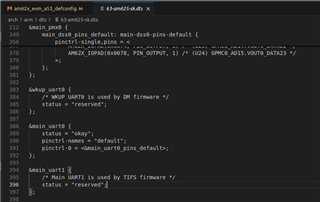

Can I use UART1 instead of UART0 during DFU?
I was able to perform a DFU update with uart1 by referring to the forum. Is there any problem if I use it with uart1?

main_uart1 is reserved for TIFS logs:

if just outputting TIFS logs, wouldn't it be okay to use u-boot console main_uart1?

Yes this should be possible. I have not tried this out yet but you can refer to the device tree changes required to enable main_uart1 as well as add its alias in the chosen section of the dt file, as mentioned here: https://e2e.ti.com/support/processors-group/processors/f/processors-forum/1319645/am6421-main-uart1-unresponsive-r5-spl
