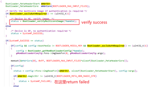

We are testing sbl+hlos boot on TDA4EN evm board which sdk version is SDK9.2.But it is block because of app file verify failed(Bootloader_verifyMulticoreImage() return failed ).

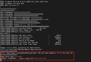

After I replace all files what I generated,The uart output as shown in the following picture.Now I have some questions:
1)Did I take any wrong steps?
2)Why SBL boot failed and how to make it boot successfully?
