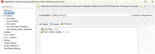

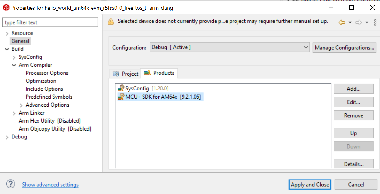

    Import the example project in CCS and right click on it and open properties.
    Select the General tab and inside General select Products.
    Please refer below screenshot.
    Now add the SDK version you want to use. After adding the appropriate SDK click in Apply and Close to save changes.

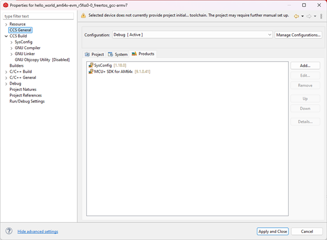

  • Hi Tushar,
    Yes, that changes the SDK version for that project but the project wizard is still creating projects for the 9.1.0.41 SDK even though I have 10.00.00.20 installed. Do you know how I change that ?

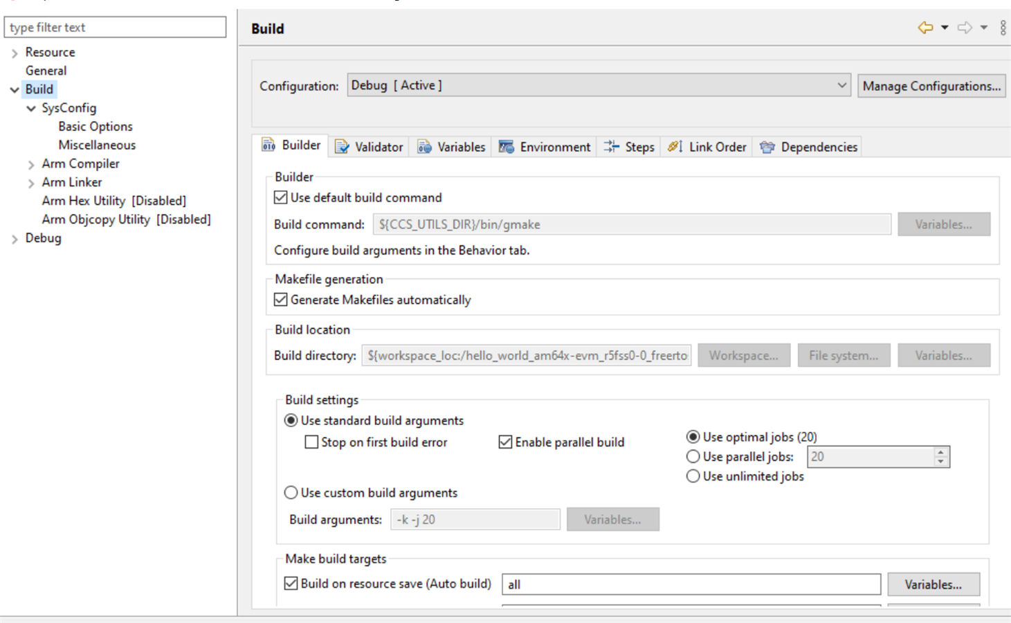

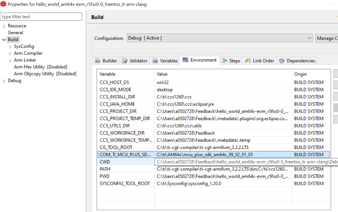

  • Hi Jon,
    Can you please check the below properties for example project and share the result?
    Please check the Environment tab in project property as shown below and check for MCU+SDK path.
    Also check the Builder property and ensure Generate makefiles automatically is checked.
    Tushar

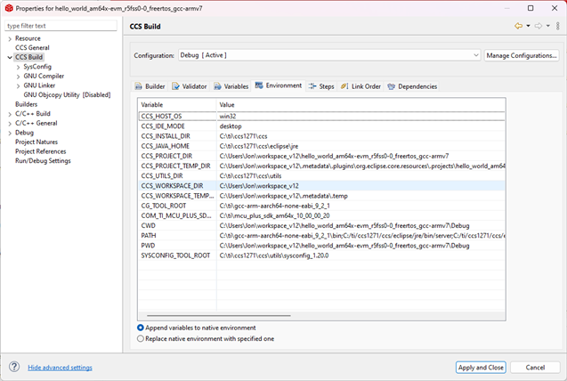

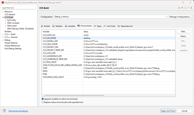

  • Hi Tushar,
    So when I create the example project using the project wizard
    and Environment variables
    and then after updating the project to SysConfig v1.20.0 and MCU+ SDK 10.0.0.20
    the environment variables update as you'd expect
    but the question remains how do I get the project wizard to generate projects using the 10.0.0.20 SDK in the first place ???
    Generate makefiles automatically is ticked by the way

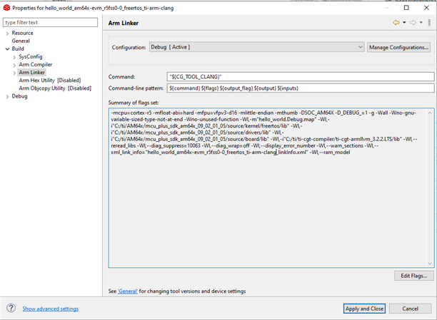

  • Hi Jon,

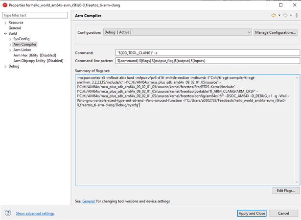

    Can you please check "Summary of flags Set" option used for compiling the project? Check for the Arm Compiler options under properties tab. Make sure MCU+SDK v10.0 is used for compilation.
    Please refer below image. (I am using SDK v9.2.1.5)
    Can you please also check "Summary of flags Set" option used for linking the project? Check for the Arm Linker options under properties tab. Make sure MCU+SDK v10.0 is used for linking.
    Please use the rebuild option while building your project.

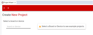

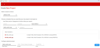

    Can you please share the screenshot of project wizard where you see SDK v9 is getting selected?
    Tushar

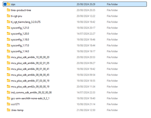

  • Hi Tushar,
    The project wizard doesn't give the option of selecting an SDK version (at least not for me).
    but in terms of what I have installed
    so I want the project wizard to create examples using the v10 SDK.
    In terms of resource explorer 09.01.00.41 is listed as the latest version so it looks like something hasn't been updated when the later SDKs have been released.
