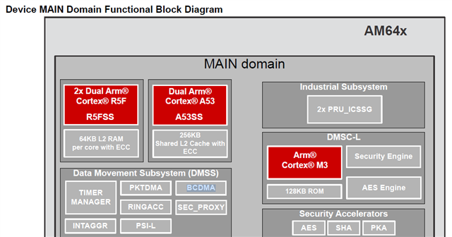

    Q1.
    I looked at the TRM.
    There is only one BCDMA0, but does that mean that multiple DMA channels are realized by reusing one module called BCDMA0?
    Does this mean that if I prepare the DMA settings in memory, I can create unlimited DMA channels?
    I don't yet understand the details of BCDMA.

  • There is only one BCDMA0, but does that mean that multiple DMA channels are realized by reusing one module called BCDMA0?
    Yes, your understanding is correct.
    With one BCDMA, you can create many DMA channel allocations.
    Please look at the syscfg where you can enable multiple DMA channels.
