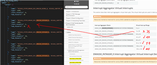

I noticed a potential discrepancy in TI's documentation regarding the interrupt resource count for AM64X_DEV_DMASS0_INTAGGR_0. The documentation states that the interrupt range is from 5 to 39, implying that 35 resources are available. However, sysfw_boardcfg_rules.json indicates that 36 resources are available. Could you clarify which one is correct?"
under section  Interrupt Aggregator Virtual Interrupts
https://software-dl.ti.com/tisci/esd/latest/5_soc_doc/am64x/interrupt_cfg.html
sysfw_boardcfg_rules.json, under line 2215
for am64x.
Thanks.
    Thanks for reporting the above bug.
    The TISCI documentation is correct.
    The correct value for sysfw_boardcfg_rules.json has given below.
        "name": "RESASG_UTYPE(AM64X_DEV_DMASS0_INTAGGR_0, RESASG_SUBTYPE_IA_VINT)",
        "type": 1802,
        "start_resource": 5,
        "num_resource": 35
    I will create an internal Jira ticket for it to be fixed in upcoming releases.
    Hope the above information helps.
