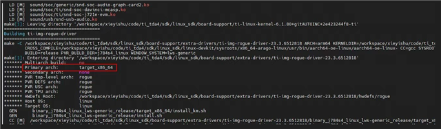

As shown in the figure below, the GPU driver always compiles to x86. Please help to see how to change it to ARM.
BR,
Biao
    It looks like the "CC=gcc" might be the issue, as that would force the compiler to use gcc as opposed to the cross compiler. Can you double check where that is coming from?
    In Makefile_ti-img-rogue-driver, can you remove CC=gcc and try again?
