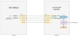

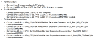

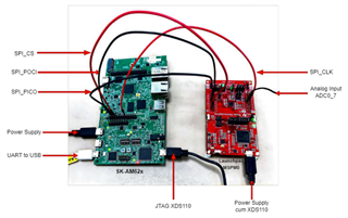

    My customer would like to clarify the followings even though the interfacing is very clear.
    Please check the attachment for the interfacing btw AM62x and MSPM0L1306.
    6281.AM625SIP-MSPM0 IF.xlsx
    1. Please tell me which of the 16 pins of MSPM0L1306 are required to be connected and which are not for ADC use case.
    Please comment on which pins are required to be connected and how to handle unused pins if not used.
    2. They ask if the peripheral circuitry (power capacitor capacity, etc.) can be used according to (MCU099_LP-MSPM0L1306 with PCB.pdf).
    3. if they want to connect a debugger, can they just connect SWDIO, SWCLK two wires with AM62 MCU or do they need other wires?
    -> I think they can connect XDS Debugger according to following diagram. not with AM62x. right? I don't know why they are confused.
    The following diagram has been introduced via application what you provided.
    * Connection btw AM62x and MSPM0L1306
    Thanks.
    Jack
  • Hey Jack,
    The pins related to SPI communication [the pins 4,9,10,11 in your attachment] are mandatory for the SPI communication between AM62x and MSPM0.
    As for the ADC0 pins [1,12,13,14 in your attachment] are dependent on the user application. ADC0 can take inputs from multiple channels and sample them in sequential mode [if more than one are used]. Which pin is to be used depends on which channel for the ADC is configured. Customer may refer to the following example in MSPM0 SDK:
