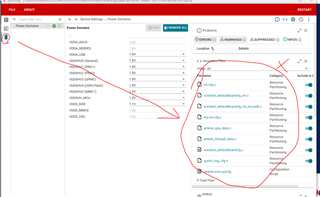

I know we can config power management during SBL run.
1.
but how about the power config file?
However this file is no any power management config.  Please take a look
source\drivers\sciclient\sciclient_default_boardcfg\am64x\sciclient_defaultBoardcfg_pm.c
2. furthermore, if we are using sysconfig,  sciclient_defaultBoardcfg_pm.c is not generated.
I mean
gmake -s -f .\makefile_board configure SOC=am64x
gmake -s -f .\makefile_board configure-gen SOC=am64x
power managerment is not over there
3. is that saying ti did not recommend power management setting  config during RBL.   Please do it in SBL?
Thanks.

    It is not why question., it is more about capability.  Can I do  PM in RBL?
    if it is capable of doing it in RBL, can you provide me an example.  eg:  sciclient_defaultBoardcfg_pm.c
    Currently, your sample code, is only config this pm in SBL, not in rbl.
    I don't want to change the PM config. I just want to do it in RBL.   and remove from SBL.
    Thanks.
  • Hello Jun,
    The boot flow sequence is RBL → SBL → Application.
    RBL runs on the ROM memory and can't be modified by the user.
    Users should modify the SBL and Application code only.
    In the SBL, we just control the rm and pm cfg all domains can access or not and this control only is doing.
    The above attached image power configurations belong to Hw and there is no control in software.
    Anil.
