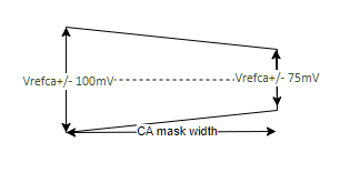

3. Targeted DDR4 eye mask definitions/requirements (CLK,ADDRS, DQ(read & write cycle), DQS(read & write cycle)).

    3. JEDEC does not define eye masks for DDR4
    CA(Command/Address) Mask - DDR4 @ DRAM Die Pad 1600MT/s
    Shape    Trapezoid
    Height     Vrefca+/-100mV(setup),Vrefca+/-75mV(hold)
    Width     366ps + SR Derating (0.29280 tCK for 0 derating)
