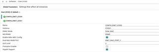

There is an example in \examples\networking\lwip\enet_lwip_icssg. It uses 2 PHY and two ethernet ports. We have our custom board and need to run the same example, but only one PHY and one ethernet port are available. How should we proceed to enable just one port? Do we need to use the "custom board" checkbox?
I'm asking also to see if it can work with just one port.

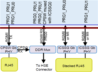

This is because EVM design to test 2-ports of ICSSG and 1-port of CPSW out of box.
You should be able to design your board as per your need.
You can refer below example
mcu_plus_sdk_am64x_09_02_01_05/examples/networking/enet_layer2_icssg/icssg_layer2_dualmac
AM64x MCU+ SDK: Enet Layer 2 ICSSG Example (ti.com)

Thank you! It worked!
Just a last question: is enabling both ICSSG in DUAL MAC recommended, even if another one is not wired? We've enabled just one, and it seems to work fine.
It should not create a problem. Still, I will cross check with dev team and get back to you.

Hello Ashwani,
Sorry for the delay. It seems to work fine. We'll continue testing, and if there is a problem, we'll open another question.
Thank you for the help!
