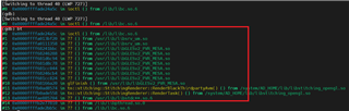

The GPU is stuck at the glFinish function. See dump.png for details.
Use 'cat /sys/kernel/debug/pvr/status' to view the status of the GPU. The Firmware Status shows NOT RESPONDING (KCCB stalled). See status.png for details.
Check the dmesg printout, which also contains abnormal information of PVR. See dmesg.log for details.
