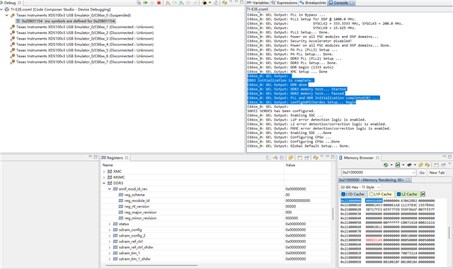

Hi, all:
CCS Version: 5.5.0.00077
Chip: TMS320C6678
Options:
  1. Connect to the device via J-TAG(XDS100V3) in CCS
  2. Launch the target with a ccxml
  3. Connect core0;

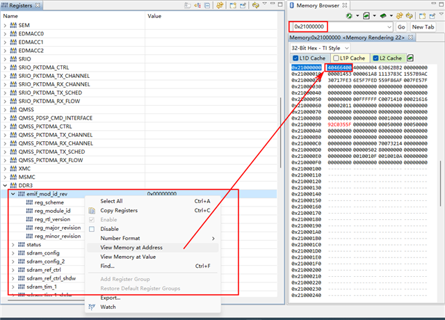

  4. Open the Register View, and check DDR3 register status, which value is 0x0000_0000;
  5. Right Click on the emif_mod_id_rev, and select "View Memory at Adress" and it shows in  the memroy View (Like below):
Question: Why is the "Rester View" different from the real status in the  Memory View? (The memory view is the real register's condition.)
Thanks!
