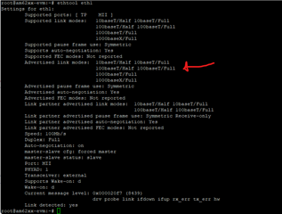

AM620-Q1: Ethernet issue on custom board boot m-eth1
Part Number: AM620-Q1
Other Parts Discussed in Thread: DP83869

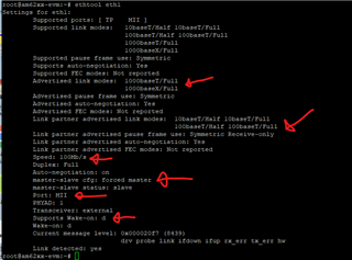

During boot, I get the following:

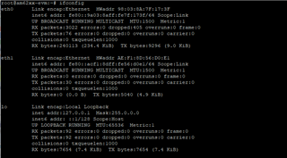

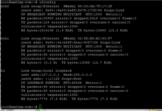

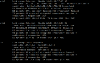

When boot completes and I do an ifconfig I get:
I can ping eth0 but not eth1.
    Is this a custom board?
    Could you please attach the full boot log?

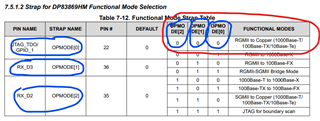

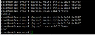

    The PHY is not being identified during boot as there may be communication issues with the PHY over the MDIO bus.
    What is the PHY that is attached on eth1?

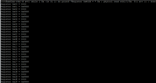

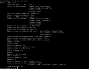

    What does ethtool eth1 say when you have a cable connected between eth1 and a link partner? This will indicate both communication between the Processor and the PHY and if the PHY is in a good state.
    Schuyler
  • Schuler,
    Sorry for the delayed response - holiday.  I've attached the full boot log:

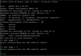

    U-Boot 2023.04-dirty (Sep 03 2024 - 16:33:11 -0400)
    SoC:   AM62X SR1.0 HS-FS
    Model: Texas Instruments AM625 SK
    EEPROM not available at 80, trying to read at 81
    Reading on-board EEPROM at 0x51 failed -121
    DRAM:  no bloblist found!2 GiB
    Core:  64 devices, 27 uclasses, devicetree: separate
    MMC:   mmc@fa10000: 0, mmc@fa00000: 1
    Loading Environment from nowhere... OK
    In:    serial
    Out:   serial
    Err:   serial
    Net:   eth0: ethernet@8000000port@1
    Warning: ethernet@8000000port@2 (eth1) using random MAC address - 02:5e:b8:ac:80:f7
    , eth1: ethernet@8000000port@2
    Hit any key to stop autoboot:  0

    [    6.369974] am65-cpsw-nuss 8000000.ethernet eth1: PHY [8000f00.mdio:01] driver [Generic PHY] (irq=POLL)
    [    6.370023] am65-cpsw-nuss 8000000.ethernet eth1: configuring for phy/rgmii-rxid link mode
    [    6.371983] am65-cpsw-nuss 8000000.ethernet eth1: Link is Up - 100Mbps/Full - flow control rx/tx
    [    6.384120] IPv6: ADDRCONF(NETDEV_CHANGE): eth1: link becomes ready
    [    6.416156] am65-cpsw-nuss 8000000.ethernet eth0: PHY [8000f00.mdio:00] driver [TI DP83869] (irq=POLL)

    We're using the same transceiver for both eth0 and eth1 - "DP83869HMRGZR".
    Here's the output from ethtool eth1:
    Here's the output of "ifconfig" on eth1:
    When connected to eth0, I get an auto-negotiated IP.
    Thanks for the screen caps.
    While the PHY is not being identified the ethtool output is showing that the PHY is accessible on the MDIO bus and the state of the PHY looks to be good as well.  A link is detected and the speed is 100MBps. From the this perspective the interface should be functioning. Please add the results of ethtool -S eth1.
    Since the eth1 PHY is not being detected the appropriate driver is not being loaded. The key would be that the rxid is an extended register mode parameter that would only get loaded into the PHY by the PHY driver. At 100Mbps the internal delay will not matter.
    I am not following the IP address assignment. The second screen cap shows both interfaces without any IP address. Can you only plug-in a cable to eth1 and see if the port is able to obtain an IP address? If so then the port should be ping-able. Please note that the two ports cannot be plugged in the same subnet (eg:192.168.1.x), this network topology is not allowed. The two ethernet ports must be on physically separate subnets.
    Schuyler
  • Schuyler,
    See attached:

    Regarding the auto-negotiating, it only occurs on eth0.  When I connect ethernet it gets assigned an IP and I can connect to a PC.  The same is NOT the case for eth1.  I can manually assign an IP address to eth1 but I can't "ping" it like eth0 from my PC.  Our goal is to have both ports at 1000Mb/s like eth0 on boot up.  Here's ethtool eth0 & eth1 output:
    root@am62xx-evm:~/Test# ethtool eth0
    Settings for eth0:
            Supported ports: [ TP    MII ]
            Supported link modes:   10baseT/Half 10baseT/Full
                                    100baseT/Half 100baseT/Full
                                    1000baseT/Full
                                    1000baseX/Full
            Supported pause frame use: Symmetric
            Supports auto-negotiation: Yes
            Supported FEC modes: Not reported
            Advertised link modes:  10baseT/Half 10baseT/Full
                                    1000baseT/Full
                                    1000baseX/Full
            Advertised pause frame use: Symmetric
            Advertised auto-negotiation: Yes
            Advertised FEC modes: Not reported
            Link partner advertised link modes:  10baseT/Half 10baseT/Full
                                                 1000baseT/Full
            Link partner advertised pause frame use: Symmetric
            Link partner advertised auto-negotiation: Yes
            Link partner advertised FEC modes: Not reported
            Speed: 1000Mb/s
            Duplex: Full
            Auto-negotiation: on
            master-slave cfg: preferred slave
            master-slave status: slave
            Port: Twisted Pair
            PHYAD: 0
            Transceiver: external
            MDI-X: Unknown
            Supports Wake-on: ubgs
            Wake-on: d
            SecureOn password: 00:00:00:00:00:00
            Current message level: 0x000020f7 (8439)
                                   drv probe link ifdown ifup rx_err tx_err hw
            Link detected: yes
    root@am62xx-evm:~/Test# ethtool eth1
    Settings for eth1:
                                    1000baseT/Full
                                    1000baseX/Full
                                    1000baseT/Full
                                    1000baseX/Full
            Link partner advertised pause frame use: Symmetric Receive-only
            Speed: 100Mb/s
            Duplex: Full
            master-slave cfg: forced master
            Port: MII
            PHYAD: 1
            Supports Wake-on: d
            Wake-on: d
            Link detected: yes

    Thank you for the ethtool -S eth1 output. If you connected a PC running Wireshark it would be good to see if there is any traffic coming from eth1. The statistics is showing that TX traffic is showing packets left the MAC, this does not mean the packets actually cross the PHY. This has to be checked from the link partner perspective.
    tx_good_frames: 77
    There is not any received traffic:
    rx_good_frames: 0
    So it appears the ethtool eth1 is showing data we expect, link detection, PHY address, etc. But the PHY does not appear to functioning in the receive direction. This may have to do with the PHY not being identified and therefore the driver not loading parameters for RGMII operation. I will ask the TI PHY team to add to this thread.

    The simpler task might be to stop in u-boot and use this command to read register 3 of the PHY. There is a utility in u-boot to read PHY registers called mii.
    The command format is mii dump <PHY address> <register address>
    So based on what I see here in this thread you would enter this command:
    mii dump 1 3
    We are looking to see the ID that should match the datasheet.
    Schuyler
  • Schuyler,
    I'm not sure if these are the right commands but I found them in another thread:
    For eth0
    For eth1
    If I executed this correctly, both eth0 and eth1 have the same value in register 3 (and most other registers).
    u-boot is not as useful:
    With ID = 1:
    Current log:

  • Jim,
    The concerning thing is why the second run of phytool is showing different results from the previous run. The PHY ID is correct for both PHYs. I will ask the PHY team to provide more insight here.
    It is odd that the register value is correct but the PHY ID is not being detected on eth1.
    Schuyler

    eth1 doesn't appear to be auto-negotiating.  The first call to ifconfig is with eth0 connected to network.  The second call to ifconfig is with eth1 connected to network.
    Are eth0 and eth1 both connected to the same switch? If so please disconnect eth0 and then check if eth1 is able to obtain an IP address.
    Schuyler
  • Shuyler,
    I only connect one or the other (to the same switch).  If eth0 is connected, eth1 is not (and vice versa).

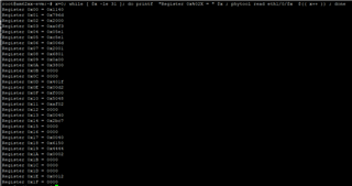

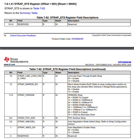

  • Shuyler,
    After the modifications for the USB issue, here are some of the routine returns we did earlier -

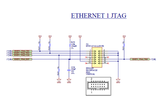

    It seems like eth0 and eth1 are getting configured differently.
    eth0:
    eth1: (No SecureOn Password: listing)
    Could a strapping issue be the cause of the differences on eth1?

  • Hi Jim.
    The items you are pointing out are read from the PHY.  Are eth1 and eth0 being plugged into the same link partner? The reason I ask is because is the ethtool output is read directly from the PHY. So both should PHYs read the same parameters. That maybe what you are trying to tell me though.
    So if both ports are plugged in turn to the same link partner and they read differently on ethtool then perhaps you question about HW strapping would be something to look at. I will consult with the PHY team.
    This might explain the identification issue that is seen on eth1.
    Schuyler
  • Schuyler,
    Yes, both eth0 and eth1 get plugged into the same link partner.  Basically, I move the ethernet cable from eth0 to eth1 (or vice versa) and run one port at a time.
    Let me know what the PHY team thinks.  As I mentioned previously, the USB problem was resolved by having the TI team (first) show me where to insert printk() statements in the kernel code and then I would rebuild the kernel code and send the TI team the boot log to review.  I can do that for this if needed.
  • Schuyler,
    This morning when I executed ethtool eth1, two additional "Advertised link modes" are seen in the output (compared to yesterday):
    Here's how we think we should be strapped:
    Do we need pull down resisters on all these pins?  What would be the recommended resistor value?
    From this image it seems like phy[1] is not getting recognized properly. Can you confirm that phy[1] is correctly strapped to have PHYADDR = 1?
    Alvaro

  • Hi Jim!
    I read through this post and would like to reel it back in a bit and slowly start from the beginning. As mentioned in my previous reply, PHY[1] is not being recognized. This means that the software is expecting PHY Address = 1 and the PHY is not being strapped correctly.
    Please confirm if both PHY[0] and PHY[1] are DP83869s, one with Address: 0 and the other with Address:1. Do both of these PHYs share a MDC/MDIO bus that is connected to the processor? If so, they each must have a unique PHY Address.
    The DP83869 PHY Address is configured via the RX_D0 and RX_D1 pins. The PHY Address cannot be changed via software.
    For PHY[0], these pins can be left floating and it will correctly configure itself as PHY ADDRESS = 0 (Both RX_D0 and RX_D1 are in Mode 0).
    For PHY[1], RX_D1 can be left in Mode 0 and RX_D0 needs to be in Mode 1.
    • For Mode 1, please use a 10kΩ Rhi and 2.49kΩ Rlo resistor.
    Alvaro

  • Alvaro,
    That modification appears to have been the solution:
    Can you comment on the RX_D2, RX_D3 and JTAG_TDO/GPIO_1 pins?
    Can we connect both ethernet ports (eth0 and eth1) to the same subnet?
  • Hi Jim!
    Glad to hear that PHY[1] is getting recognized now!
    Now to configure the correct OPMODE (determined by RX_D2, RX_D3, and JTAG_TDO), we can read Register 0x6E to confirm what OPMODE the PHY booted up with. Please see See Section 2.1 Configuring Correct Operational Mode from the DP83869 Troubleshooting Guide for more information.
    Please note that Register 0x6E is an extended Register, please see this FAQ for more information on how to access.
    Yes! From your example, eth0 can be 192.168.1.80 and eth1 can be 192.168.1.90

  • Alvaro,
    I think I can read that register using phytool (using the extended register sequence in the document you referenced)?
    Here's the output:
    Is there another strapping adjustment needed on phy[1]?
    Here? ->
  • Hi Jim!
    The reads for both eth0 and eth1 look good! The only bit that is different, bit 4, is due to the PHY Address. Both are set into OPMODE: 000 RGMII to Copper. Seems like you're good to go!
    Alvaro
