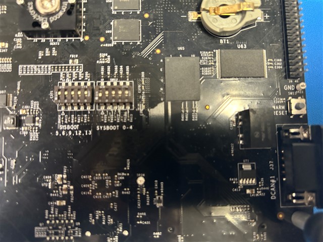

I have AM437x hs evm. And I am not able to boot up the board using sd card .
I have downloaded and set up the sdk  - :processor-sdk-linux-am437x-hs-evm-bin-06.03.00.106 .  I have used createsdcard.sh script to flash the sd card.
When I power up the board nothing displaying. Can you please help for the same ?

  • Hi Prashant,
    Your steps looks good.
    What is your SYSBOOT pin setup?
    Refer to below for details on SYSBOOT pins and AM437x EVM setup.
    - AM43xx TRM
    https://www.ti.com/lit/pdf/spruhl7
    <5.2.5.2 SYSBOOT Configuration Pins>
    - AM437x EVM onlinr guide
    https://www.ti.com/tool/TMDSEVM437X
    -Hong
  • Hello Hong,
    I have checked the sysboot setting as belo
    To boot an AM437x EVM,
    • SW12: Sets sysboot bits 0 to 4
    • SW11: Sets sysboot bits 5, 6, 9, 12, and 13
    As mentioned in quick guide it is all on. Still could not see any logs on serial port. At least uboot should execute.
    Prashant
  • Hi Prashant,
    I'm using the DIP switch setting as attached for booting from SD on AM437X EVM.
    -Hong
