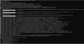

3.export SOC=am68pa
4. source ./setup.sh
I didn't care about this issue.

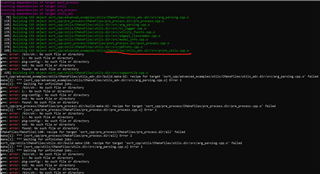

6.mkdir build && cd build
cmake ../examples && make -j && cd ..
There is an error here.
I compared the file directory on GitHub and found that there is indeed no 'CMakeFiles' folder.
How to solve it? We look forward to your reply.

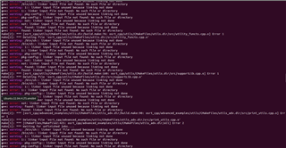

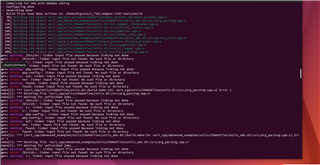

    I have upgraded the system to Ubuntu 22.04. I have successfully completed the installation of edgeai-tidl-tools. I want to Compile and Validate on X86_PC.
    When I was executing "cmake ../examples && make -j && cd ..", an error occurred.
    From the error message, it seems that some files are missing.I checked the 'build' folder and confirmed that those files do not exist.
    My branch is master.
    My python version is 3.10.
    How should I solve the above problem? Please help.
