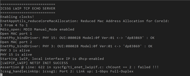

AM6422: Issue with Enet Lwip TCP Server Example on ICSSG on TMDS64EVM
Part Number: AM6422
Hello
I am using the AM64x MCU+ SDK (version 09.02.01) to implement the ICSSG LWIP TCP ECHO SERVER and facing multiple issues that appear to be discrepancies between the actual behavior and the SDK documentation. These issues persist across both static and dynamic IP configurations.
SDK Version: 09.02.01
Core Issues
1. Assertion Failure in Both Configurations: Regardless of using static or DHCP IP configuration, I encounter an assertion error:
Assertion @ Line: 111 in /nightlybuilds/mcupsdk_internal/jenkins/mcu_plus_sdk_am64x_09_02_01_05/source/networking/enet/core/src/core/enet_queue.c: node != NULL
2. Documentation vs. Actual Behavior:
- The example code documentation states that out-of-the-box, the code should operate in "Switch mode," yet the Sysconfig indicates it's set to "Dual MAC mode."
- The log outputs from the example do not match the expected outputs as per the SDK documentation, particularly concerning network initialization and IP address assignment.
3. Difficulty Switching from DHCP to Static IP:
- The documentation instructs to disable DHCP and AUTOIP by removing `dhcp_start` and `autoip_start` calls. However, I am unable to locate these calls in the codebase, making it impossible to follow the prescribed steps for setting up a static IP.
1. How can I resolve the assertion error that occurs in both the static and dynamic IP configurations? Are there known bugs or patches for this issue?
2. Can you clarify the operational mode discrepancy? Why does the Sysconfig indicate "Dual MAC mode" when the documentation states "Switch mode" should be default?
3. Where exactly should I look to find and remove the `dhcp_start` and `autoip_start` calls within the ICSSG LWIP TCP ECHO SERVER example or related files in the SDK?
4. Are there additional steps or corrections in the documentation regarding setting up a static IP that I should be aware of?

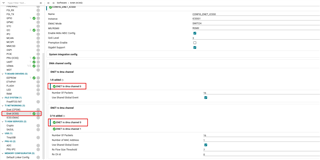

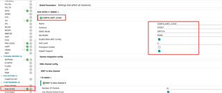

    Please share the screenshot of this ?

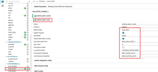

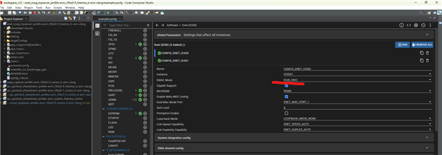

  • Now I am using the latest SDK  v10
    Out of the box the EMAC mode is set to dual mac

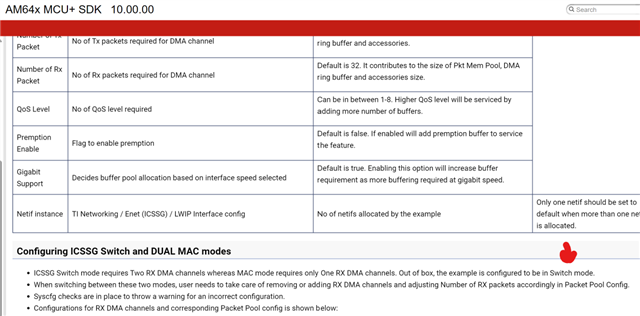

  • Hi ,
    I think you are confusing with DUAL MAC and Switch mode.
    Please refer Configuring ICSSG DUAL MAC with two MAC ports section of AM64x MCU+ SDK: Enet Layer 2 ICSSG Example (ti.com)
    This might be a silly question but if the example should run as switch out of the box should the emac mode be set to DUAL_MAC?

  • Can you help me with the end use case ?
    I want to create a TCP server that can handle Modbus packets with the ICSSGI in switch mode.
    I was able to handle modbus packets with this example. The only problem being that the example is in dual mac out of the box.
    AM64x MCU+ SDK: Enet Lwip TCP Server Example on ICSSG (ti.com)
    Since I need a tcp server but with icssgi in switch mode I attempt to modify the sysconfig of this example by following steps given in

    But upon running i get
  • Hi ,
    It shows Rx/Tx channels are not properly configured.
    I am assuming you have removed CONFIG_ENET_ICSS1 from below screenshot
    Change DUAL MAC setting to SWITCH mode as below
    Rx and Tx DMA channels
    Single NETIF for 2-Rx and 1-Tx channels
    Let me know if you are still facing issue?
    Ashwani
  • Hi Ashwani,
    Thanks a lot for your prompt response and guidance!
    The Rx DMA used for the Netif had to be set to [0,1].
