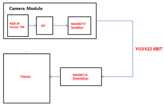

Hi.
I am creating a new target board and connected new camera. We are using RGB+IR virtual modules.
It is as shown in the figure below.
Additionally, the camera sensor config code has been modified as shown below.

1. Please confirm this code that sensor settings are correct.(YUV422 8bit format)
2. I checked the MAX96714 Deserilazer setting and confirmed with oscilloscope that the MIPI data is coming out. Please tell me what I need to do to receive data with TDA4VM MIPI CSI-0 or how to verify it.
3. I would like to know the part that checks whether MIPI data is received in run_app_multi_cam.
