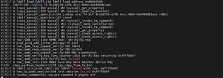

In the process of developing with TI AM62x chip and SDK 8.6, we implemented the secure storage function through the OP-TEE framework, specifically using the securetool tool to call the OP-TEE secure storage API to implement encrypted data storage.
However, it is currently found that under the same firmware configuration, the secure storage function has inconsistent performance on two different SOM boards:
• On one SOM board, the secure storage function can be executed normally.
• On another SOM board, whether using HS-FS or HS-SE, the secure storage function behaves abnormally and cannot perform related operations correctly.
Please help to share some insights.

  • Hi Zekun,
       Could you please change the board to UAR boot mode, then parse the board type firstly to check is there any difference between the two boards?
       According to the fail log, TEEC_Openseesion failed with code 0xffff000f, could we ask customer provide more detail info ? such as rebuild bl32 with debug mode, with option CFG_TEE_CORE_LOG_LEVEL=4 CFG_TEE_CORE_DEBUG=y
       The session can't open, the optee service is enabled?

  • 安全存储失败的板子的开机串口日志如下:

  • According to the log "MAC mismatched:" ,  I suggest you debug the function "tee_rpmb_resp_unpack_verify", please check the what's the difference of uuid and fek.
  • 异常的板子获取的uuid和fek为0,然后就是打印“MAC mismatched”,正常的板子可以正常获取uuid和fek
  • Could you please debug the  HUK status by the function tee_otp_get_hw_unique_key and feedback?
