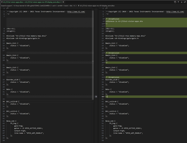

I made new dtso for a72 dss display based on k3-j721s2-vision-apps.dtso as done before in psdk 9.0 j721s2.
But the 'modetest -M tidss -c' was not working as below.
Below is the compare of two files.
I enabled main_i2c4, seredes_wiz0, dss in a72 (Linux).

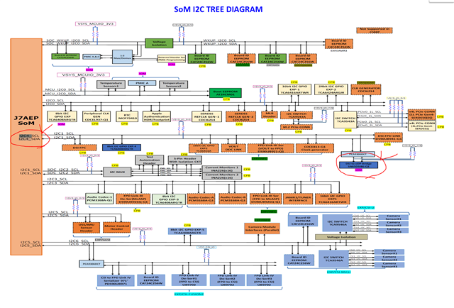

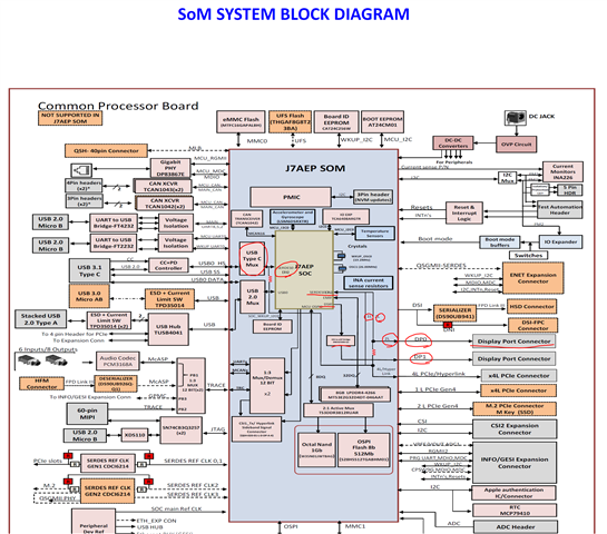

According to the J721S2 SOM board design document below, i2c4 seems to be related to DSI to eDP Bidge, seredes0 to USB Type C Mux, and DP0, but I don't quite understand it.
Why doesn't it work even if I modify it the same as 9.0?
A patch needs to be applied to enable USB 3.0, but I would like the display issue to be resolved first.

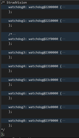

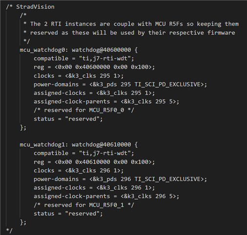

    Additionally, if removing all watchdog codes newly added on 9.2, the 'modetest -M tidss -c' is working well.
    How would it be correct?
  • k3-j721s2-main.dtsi
    k3-j721s2-mcu-wakeup.dtsi
  • The removed watchdog codes above occurs syntax error.
    But the vision apps dtbo is built.
    I will more try.
    Could you let me know how to fix device tree codes for uising DSS on A72 in PSDK 9.2 J721S2?

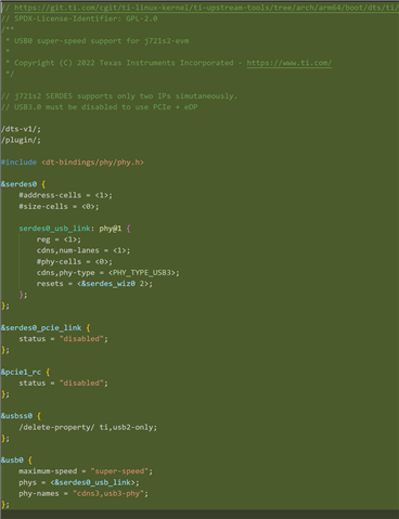

    k3-j721s2-common-proc-board.dts
    k3-j721s2-usb3.dtso
    uEnv.txt
    Is there anything wrong with using it like this?

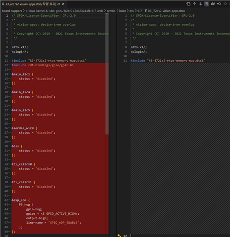

  • Hi Lee,
    ok, lets first fix the display issue.
    From the vision apps dtb file, can you please remove below two entries and then rebuild dtb file and use it in the BOOT partition?
    &serdes_wiz0 {
    status = "disabled";
    &dss {
    Brijesh
  • Hi, Brijesh:
    I did try that you suggest.
    But the tidss is not working as below.
    root@j721s2-evm:~# modetest -M tidss -c
    failed to open device 'tidss': No such file or directory
    UK

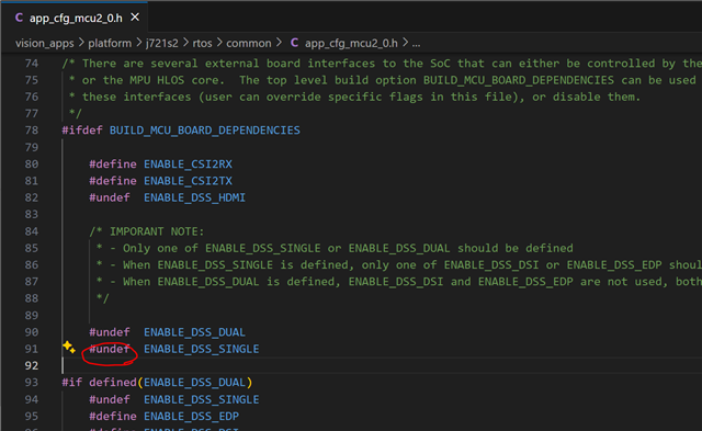

  • Hi UK,
    Ok, Can you try the below?
    in vision_apps, can you disable the usage of display macro highlighted below and do a clean rebuild of vision_apps and try again?
    This file is in vision_apps/platform/j721s2/rtos/common/app_cfg_mcu2_0.h
    Nikhil

  • Hi, Brijesh:
    "Can you just remove entries from vision apps dtb file as i suggested earlier and remove DSS from R5F as Nikhil suggested and try it out?" - Brijesh
    Does 'remove entires' mean as below?
    If I use built vision apps dtbo as above, I get boot log as below.
