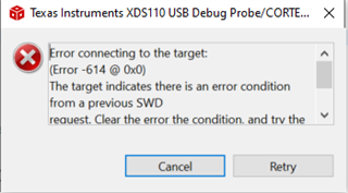

- flash the bootloader at address 0x1000 - NOT OK. I've got the error message 614:

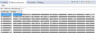

after reseting and checking the memory content, it looks like that the memory at address 0x0 was modified (at address 0x0 is no more the stack pointer at the end of the RAM, but something else).

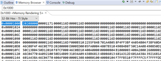

The memory content at address 0x1000, wher i have flashed, the empty "bootloader" looks ok:

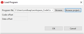

I mention that I have tried with all the variants bellow (even with do not erase Flash memory, since every time i flash at a new address, so there is no need to erase):
Also, I have tried with both, debug and load:
Nevertheless, it looks like everytime, the flash is overwriten.

    From my perspective, the interrupt table from 0x0 should be the similar with different compiler. You screenshot is not behavior like the interrupt table.
    I suggest you can start from this, check whether the firmware is correct or not. If the firmware is correct, then there must be some code in your project do modification with flash.
