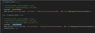

After I migrating Rtos from 0805 to 0902 focus on pdk modules, I test can send failure.
I confirm my environment is ok because I re-flash old binary of 0805 SDK, it's working.
Detail Step:
1. GPIO control is ok of  0902 project.
2. Timer interrupt is ok of  0902 project.
3. I find MCAN_getIntrStatus(baseAddr) of  0902 project return always 0. And baseAddr same 0805 0x40540000U and 0x40500000U.
4.  I find MCAN_getIntrStatus(baseAddr) of  0805 project success return MCAN_IR_TC_MASK    (0x00000200U). And baseAddr same 0805 0x40540000U and 0x40500000U.
