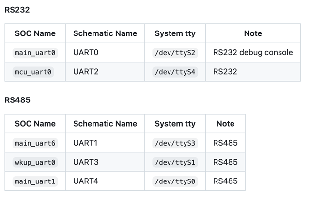

My project uses the AM62P with SDK version 10.00.07.04 (Kernel 6.6) and requires 5 UARTs, some of which need to be configured as RS485.
My question is:
  1. In the EVM's DTS, main_uart0 has an additional interrupts-extended setting. Is this necessary?
    if this setting is necessary, how should the other UARTs be configured? I also need to enable mcu_uart0, wkup_uart0, main_uart1, and main_uart6
  2. Configure the UART port to RS485
    My schematic as below
    I'm not sure how to configure it for RS485. Could someone help me verify this?

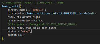

    // wkup_uart0 | UART3 | /dev/ttyS1 | RS485
    &wkup_uart0 {
    	pinctrl-names = "default";
    	pinctrl-0 = <&wkup_uart0_pins_default &UART3EN_pins_default>;
    	rs485-rts-active-high;
    	rs485-rts-delay = <0 0>;
    	rts-gpios = <&mcu_gpio0 12 GPIO_ACTIVE_HIGH>;
    	linux,rs485-enabled-at-boot-time;
    	status = "okay";
    	bootph-all;
    is this correct?

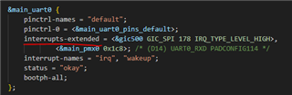

  • Hi YuYuan,
    This is for using UART0 to wake up the AM62Px device from Low Power mode. You don't need this if your project doesn't use any Low Power mode or don't use UART as the wakeup source.
    I looked at some examples, and it seems that the enable pin needs to be set as a GPIO, then passed in through rts-gpios
    The kernel driver supports both native RTS or gpio based (rts-gpios DT setting) RTS pin for RS-485 direction control. So technically you can use either way.
    However, the AM62Px UART controller supports RTS pin RS-485 mode, in which the controller manipulate the RTS pin for RS-485 direction control without software involvement. If you want to use this hardware feature, you would have to set the RTS pinmux to RTS mode, not GPIO mode, and don't set 'rts-gpios' in devicetree.

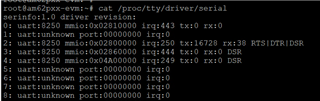

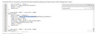

  • Hi Bin,

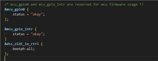

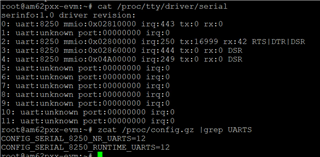

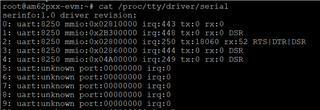

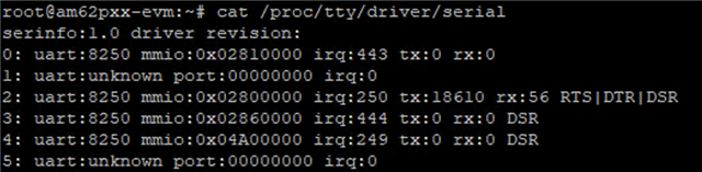

    Thanks, but do you know why "wkup_uart0" failed in my system (TI's EVM SK-AM62P-LP)?
    I tried this DTS in my kernel (I removed the other peripheral settings and kept only the UART settings that I need.)

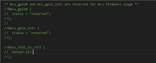

    /* mcu_gpio0 and mcu_gpio_intr are reserved for mcu firmware usage */
    //&mcu_gpio0 {
    //	status = "reserved";
    //&mcu_gpio_intr {

    // main_uart0 | UART0 | /dev/ttyS2 | RS232(Debug console)
    &main_uart0 {
    	pinctrl-0 = <&main_uart0_pins_default>;
    	//interrupts-extended = <&gic500 GIC_SPI 178 IRQ_TYPE_LEVEL_HIGH>,
    	//		<&main_pmx0 0x1c8>; /* (D14) UART0_RXD PADCONFIG114 */
    	//interrupt-names = "irq", "wakeup";
    	status = "okay";
    	bootph-all;
    // main_uart6 | UART1 | /dev/ttyS3 | RS485
    &main_uart6 {
    	pinctrl-0 = <&main_uart6_pins_default &UART1EN_pins_default>;
    	rts-gpios = <&main_gpio0 9 GPIO_ACTIVE_HIGH>;
    	status = "okay";
    	bootph-all;
    // mcu_uart0 | UART2 | /dev/ttyS4 | RS232
    &mcu_uart0{
    	pinctrl-0 = <&mcu_uart0_pins_default>;
    	status = "okay";
    	bootph-all;
    &wkup_uart0 {
    	status = "okay";
    	bootph-all;
    // main_uart1 | UART4 | /dev/ttyS0 | RS485
    &main_uart1 {
    	pinctrl-0 = <&main_uart1_pins_default &UART4EN_pins_default>;
    	rts-gpios = <&main_gpio1 8 GPIO_ACTIVE_HIGH>;
    	status = "okay";
    	bootph-all;
    This is our project requirements.

    root@am62pxx-evm:~# cat/proc/tty/driver/serial
    serinfo:1.0 driver revision:
    0: uart:8250 mmio:0x02810000 irq:443 tx:0 rx:0
    1: uart:unknown port:00000000 irq:0
    2: uart:8250 mmio:0x02800000 irq:250 tx:16983 rx:37 RTS|DTR|DSR
    3: uart:8250 mmio:0x02860000 irq:444 tx:0 rx:0 DSR
    4: uart:8250 mmio:0x04A00000 irq:249 tx:0 rx:0 DSR
    5: uart:unknown port:00000000 irq:0
    6: uart:unknown port:00000000 irq:0
    7: uart:unknown port:00000000 irq:0
    8: uart:unknown port:00000000 irq:0
    9: uart:unknown port:00000000 irq:0
    10: uart:unknown port:00000000 irq:0
    11: uart:unknown port:00000000 irq:0
    root@am62pxx-evm:~#

  • Hi YuYuan,
    Yes, it should be enabled based on this devicetree settings. I missed it earlier when searching for it.
    What is the output of the following command on your board?
    # zcat /proc/config.gz |grep UARTS
  • Please attach the kernel dtb file from your SD card. I'd like to review it.

    Okay here is the problem - your wkup uart device tree used rts-gpios, which points to a gpio pin in the mcu gpio module. However the mcu gpio module is disabled in device tree by default. This causes kernel failed to enable the wkup uart.
    Please apply the following kernel device tree patch to enable the mcu gpio module.
    diff --git a/arch/arm64/boot/dts/ti/k3-am62p5-sk.dts b/arch/arm64/boot/dts/ti/k3-am62p5-sk.dts
    index 4f8557d3e8b1..9105a0c90bd1 100644
    --- a/arch/arm64/boot/dts/ti/k3-am62p5-sk.dts
    +++ b/arch/arm64/boot/dts/ti/k3-am62p5-sk.dts
    @@ -822,17 +823,21 @@ &mcu_gpio0 {
    -       status = "reserved";
    +       status = "okay";
     &mcu_gpio_intr {
    +       status = "okay";
  • Hi Bin,
    I tried your solution, but it did not work.
    If you look at my DTS, I had already commented out those lines before.
  • Hi YuYuan,
    For debugging, can you please try to remove the following line from the &wkup_uart0 node in the kernel device tree to see if kernel can initialize the wkup uart?
  • Hi Bin,
    I removed the rts-gpio, but the result is still the same.
  • Please attach the kernel log with the rts-gpios removed.
  • Hi Bin, I've attached to the shared folder   sd_card
    * 0913.log - all logs for boot
    * 0913_dmesg.log - dmesg log
  • Hi YuYuan,
    I copied your kernel dtb k3-am62p5-sk.dtb that you uploaded 6 days ago to my SDK10.0 SD card,, and booted on my SK-AM62P evm, I can see the wkup uart is initialized.
    root@am62pxx-evm:~# dmesg|grep ttyS
    [    0.000000] Kernel command line: console=ttyS2,115200n8 earlycon=ns16550a,mmio32,0x02800000 root=PARTUUID=dc89dda9-02 rw rootfstype=ext
    4 rootwait
    [    1.104256] 4a00000.serial: ttyS4 at MMIO 0x4a00000 (irq = 249, base_baud = 3000000) is a 8250
    [    1.114445] 2800000.serial: ttyS2 at MMIO 0x2800000 (irq = 250, base_baud = 3000000) is a 8250
    [    1.123346] printk: console [ttyS2] enabled
    [    1.290735] 2810000.serial: ttyS0 at MMIO 0x2810000 (irq = 443, base_baud = 3000000) is a 8250
    [    1.300659] 2860000.serial: ttyS3 at MMIO 0x2860000 (irq = 444, base_baud = 3000000) is a 8250
    [    2.550847] systemd[1]: Expecting device /dev/ttyS2...
    [    5.659752] 2b300000.serial: ttyS1 at MMIO 0x2b300000 (irq = 448, base_baud = 3000000) is a 8250
    root@am62pxx-evm:~# cat /proc/tty/driver/serial
    1: uart:8250 mmio:0x2B300000 irq:448 tx:0 rx:0 DSR
    2: uart:8250 mmio:0x02800000 irq:250 tx:12616 rx:63 RTS|DTR|DSR
  • This is really strange. When I build the entire image using Yocto, everything works fine. However, this issue occurs when I use the legacy SDK(Makefile) to update only the kernel and U-Boot.
  • Please show the details (command & logs) about how exactly you did in using the SDK Makefile to update the kernel and U-Boot.
