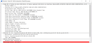

unzip the file and check for the Wireshark capture for the malformed packets. Also find the kernel configuration file used for our development.

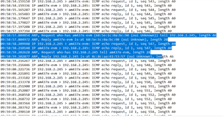

    Please provide a topology diagram of the subnet that the wireshark capture is from. There are a lot of malformed packets but we are not able to see the where the AM437 is network, is it the one issuing malformed packets for example.
    What does ethtool -S <interface name> show? Seeing malformed packets I am expecting to see for CRC.
    The console logs Paula is asking is we would like to serial console log that shows the ping command being run.

    I have connected my laptop to the AM4376 device which is our custom board . Please find the connection diagram for your reference.
    Laptop Configuration :                                                         Custom Board Configuration 1234

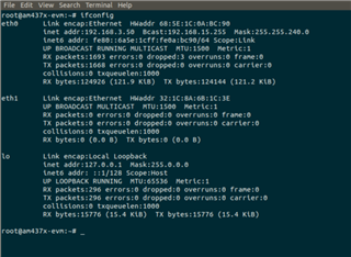

    ethtool -S eth0
    root@am437x-evm:~# ethtool -S eth0
    NIC statistics:
         txBcast: 1
         txMcast: 29
         txUcast: 323
         txOctets: 29230
         rxBcast: 9
         rxMcast: 31
         rxUcast: 325
         rxOctets: 26299
         tx64byte: 22
         tx65_127byte: 319
         tx128_255byte: 9
         tx256_511byte: 3
         tx512_1023byte: 0
         tx1024byte: 0
         rx64byte: 58
         rx65_127byte: 306
         rx128_255byte: 0
         rx256_511byte: 1
         rx512_1023byte: 0
         rx1024byte: 0
         lateColl: 0
         singleColl: 0
         multiColl: 0
         excessColl: 0
         rxMisAlignmentFrames: 0
         stormPrevCounterBC: 0
         stormPrevCounterMC: 0
         stormPrevCounterUC: 0
         macRxError: 0
         SFDError: 0
         defTx: 0
         macTxError: 0
         rxOverSizedFrames: 0
         rxUnderSizedFrames: 0
         rxCRCFrames: 0
         droppedPackets: 0
         txHWQOverFlow: 0
         txHWQUnderFlow: 0
         vlanDropped: 0
         multicastDropped: 27

    09:58:57.197394 IP am437x-evm > 192.168.2.245: ICMP echo reply, id 1, seq 546, length 40
    09:58:57.804854 ARP, Request who-has am437x-evm (68:5e:1c:0a:bc:90 (oui Unknown)) tell 192.168.2.245, length 46
    09:58:57.804972 ARP, Reply am437x-evm is-at 68:5e:1c:0a:bc:90 (oui Unknown), length 28
    09:58:58.209948 IP 192.168.2.245 > am437x-evm: ICMP echo request, id 1, seq 547, length 40
    09:58:58.210148 IP am437x-evm > 192.168.2.245: ICMP echo reply, id 1, seq 547, length 40
    09:58:59.202628 ARP, Request who-has 192.168.2.245 tell am437x-evm, length 28
    09:58:59.202877 ARP, Reply 192.168.2.245 is-at 8c:8c:aa:61:53:57 (oui Unknown), length 46
    09:58:59.216267 IP 192.168.2.245 > am437x-evm: ICMP echo request, id 1, seq 548, length 40
    09:58:59.216446 IP am437x-evm > 192.168.2.245: ICMP echo reply, id 1, seq 548, length 40
    09:59:00.221736 IP 192.168.2.245 > am437x-evm: ICMP echo request, id 1, seq 549, length 40
    09:59:00.221891 IP am437x-evm > 192.168.2.245: ICMP echo reply, id 1, seq 549, length 40
    09:59:01.233182 IP 192.168.2.245 > am437x-evm: ICMP echo request, id 1, seq 550, length 40
    09:59:01.233378 IP am437x-evm > 192.168.2.245: ICMP echo reply, id 1, seq 550, length 40
    09:59:02.251900 IP 192.168.2.245 > am437x-evm: ICMP echo request, id 1, seq 551, length 40
    09:59:02.252087 IP am437x-evm > 192.168.2.245: ICMP echo reply, id 1, seq 551, length 40
    09:59:03.268558 IP 192.168.2.245 > am437x-evm: ICMP echo request, id 1, seq 552, length 40
    09:59:03.268732 IP am437x-evm > 192.168.2.245: ICMP echo reply, id 1, seq 552, length 40
    09:59:04.283564 IP 192.168.2.245 > am437x-evm: ICMP echo request, id 1, seq 553, length 40
    09:59:04.283762 IP am437x-evm > 192.168.2.245: ICMP echo reply, id 1, seq 553, length 40
    09:59:05.290110 IP 192.168.2.245 > am437x-evm: ICMP echo request, id 1, seq 554, length 40
    09:59:05.290281 IP am437x-evm > 192.168.2.245: ICMP echo reply, id 1, seq 554, length 40
    09:59:06.295076 IP 192.168.2.245 > am437x-evm: ICMP echo request, id 1, seq 555, length 40
    09:59:06.295263 IP am437x-evm > 192.168.2.245: ICMP echo reply, id 1, seq 555, length 40
    09:59:07.310396 IP 192.168.2.245 > am437x-evm: ICMP echo request, id 1, seq 556, length 40
    09:59:07.310595 IP am437x-evm > 192.168.2.245: ICMP echo reply, id 1, seq 556, length 40
    09:59:08.322504 IP 192.168.2.245 > am437x-evm: ICMP echo request, id 1, seq 557, length 40
    09:59:08.322710 IP am437x-evm > 192.168.2.245: ICMP echo reply, id 1, seq 557, length 40
    09:59:09.335743 IP 192.168.2.245 > am437x-evm: ICMP echo request, id 1, seq 558, length 40
    09:59:09.335915 IP am437x-evm > 192.168.2.245: ICMP echo reply, id 1, seq 558, length 40
    09:59:10.350593 IP 192.168.2.245 > am437x-evm: ICMP echo request, id 1, seq 559, length 40
    09:59:10.350788 IP am437x-evm > 192.168.2.245: ICMP echo reply, id 1, seq 559, length 40
    09:59:11.365710 IP 192.168.2.245 > am437x-evm: ICMP echo request, id 1, seq 560, length 40
    09:59:11.365886 IP am437x-evm > 192.168.2.245: ICMP echo reply, id 1, seq 560, length 40
    09:59:12.379981 IP 192.168.2.245 > am437x-evm: ICMP echo request, id 1, seq 561, length 40
    09:59:12.380164 IP am437x-evm > 192.168.2.245: ICMP echo reply, id 1, seq 561, length 40
    09:59:13.387635 IP 192.168.2.245 > am437x-evm: ICMP echo request, id 1, seq 562, length 40
    09:59:13.387828 IP am437x-evm > 192.168.2.245: ICMP echo reply, id 1, seq 562, length 40
    09:59:14.398187 IP 192.168.2.245 > am437x-evm: ICMP echo request, id 1, seq 563, length 40
    09:59:14.398358 IP am437x-evm > 192.168.2.245: ICMP echo reply, id 1, seq 563, length 40
    09:59:15.407292 IP 192.168.2.245 > am437x-evm: ICMP echo request, id 1, seq 564, length 40
    09:59:15.407450 IP am437x-evm > 192.168.2.245: ICMP echo reply, id 1, seq 564, length 40
    09:59:16.414832 IP 192.168.2.245 > am437x-evm: ICMP echo request, id 1, seq 565, length 40
    09:59:16.415028 IP am437x-evm > 192.168.2.245: ICMP echo reply, id 1, seq 565, length 40
    09:59:17.430298 IP 192.168.2.245 > am437x-evm: ICMP echo request, id 1, seq 566, length 40
    09:59:17.430484 IP am437x-evm > 192.168.2.245: ICMP echo reply, id 1, seq 566, length 40
    In the above dump data there is certain logs out of which I have highlighted the one which I found while the malformed packet came.
    Also find the capture file for your reference.
    Malformpackets_10Sep2024_2.zip
    with respect to the above capture file please find the information of the device
    In the above details below are the device mac address and identifiers in the Wireshark;
    AM4376: TexasInstrum_0a:bc:90 (68:5e:1c:0a:bc:90),
    Laptop:  LCFCElectron_61:53:57 (8c:8c:aa:61:53:57)
    Also we recieve host unreachable as well in between.
    With respect to the data requested by Paula TCP dump will be ok? or required some other information as well.
    Please revert with your inputs and let us know if required any more analysis details.
    BR,
    Gaurav More

    With respect to our input I also checked for the below IP configuration. I change the Device(Custom Board) configuration to
    IP addr: 192.168.2.50  Netmask:  255.255.240.0, No Gate Way
    But still the same observation. Please find attached capture for reference,

    I have a query regarding the below screenshot
    In this you can see device is initiating the ARP request. and the malformed packets are from the device and not from the laptop. But if laptop has initiated pinging then laptop is master and then it should only initiate the ARP request. Why our device (custom board) is initiating the request?. I think there it is making issue.
    Even though I changed the IP configuration we have the same observations. while searching on the new I got to know that we should flush the ARP cache since this could be one of the reason for the malformed packet. But while searching for the same in the ARP code in the kernel module I cannot find the same.
    Also can we stop the device to initiate ping request? to check whether this is the issue? Also is there a possibility that there might be corruption at the sending side. Since we observed the even when we got the request from the laptop it sends the malformed packets. I think it is not waiting for the creation of the ARP response or request. Also one more observation is every  time it is sending header packets while sending the malformed packers. refer the screen shot below
