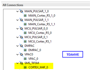

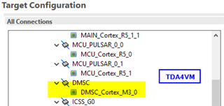

I have tested few MCAL/mcusw demos from "ti-processor-sdk-rtos-j721s2-evm-09_01_00_06", Eth communication/transmission is working.
Due to limited availability of TDA4VM Evm, trying to run MCAL/mcusw "ti-processor-sdk-rtos-j721e-evm-09_00_01_01".

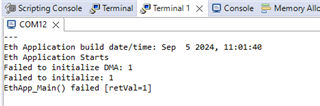

When i try to run TDA4VM eth_test_app example, getting below error during Eth initialization.

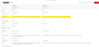

As per my knowledge the main difference between TDA4VM and TDA4VE is
MCU core Cortex_R5 is same in both EVMs.
Q) is examples are compatible on both Evms with minimal changes?
Q) what are the main differences in between TDA4VM vs TDA4VE?
