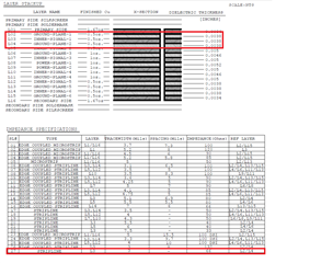

        4. When I checked out the routing of DDR0_CK_C and DDR0_CK_T differential pair, they are also T-branch lines. At the T-branch point, routing is done with single ended impedance. According to PROC141E4_FAB document, single ended impedance value should be 66 ohm.
PCB designers of the eval board used 3 mils trace width to accomplish 66-ohm single ended impedance. When I checked out the trace impedance of this line by using a software tool, I realized that line impedance is not 66-ohm, it is about 55-ohm.
I think that this impedance mismatch is really important for the clock signals.
They can still reach out 4266 Mbit/s data rate in this case? Did they test the maximum data rate of the RAM on the eval board?

    Question 4:  It is recommended to route CK as different pair from beginning to end, including T-branch segments.  The impedance of the T-branch segments should be 2x the original trace impedance, but often that is not achievable.  Recommendation is to get as close to 2x impedance as PCB allows and run simulations to determine impact.  The EVM implementation does pass as maximum frequency.
