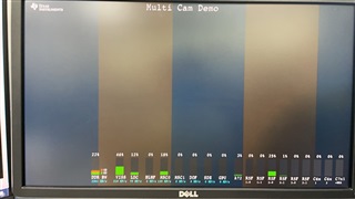

I know the current Evaluation Module and fusion board use the UB960 deserializer, which can be paired with the UB953 for test verification.
However, I only have a UB913 camera. How can I use SDK 8.6 to verify the UB913 camera on the Evaluation Module and fusion board?

  • Hi Gang,
    I tried to connect the UB913 camera to the Common processor board and run multi_cam UB9xxx_RAW12_TESTPATTERN, but I couldn't see anything on the monitor.

    root@j7-evm:/opt/vision_apps# ./run_app_multi_cam.sh
    APP: Init ... !!!
    MEM: Init ... !!!
    MEM: Initialized DMA HEAP (fd=4) !!!
    MEM: Init ... Done !!!
    IPC: Init ... !!!
    IPC: Init ... Done !!!
    REMOTE_SERVICE: Init ... !!!
    REMOTE_SERVICE: Init ... Done !!!
       238.021927 s: GTC Frequency = 200 MHz
    APP: Init ... Done !!!
       238.027129 s:  VX_ZONE_INIT:Enabled
       238.027156 s:  VX_ZONE_ERROR:Enabled
       238.027163 s:  VX_ZONE_WARNING:Enabled
       238.028212 s:  VX_ZONE_INIT:[tivxInitLocal:130] Initialization Done !!!
       238.029553 s:  VX_ZONE_INIT:[tivxHostInitLocal:93] Initialization Done for HOST !!!
       238.032423 s: ISS: Enumerating sensors ... !!!
       238.833191 s: ISS: Enumerating sensors ... found 0 : IMX390-UB953_D3
       238.833247 s: ISS: Enumerating sensors ... found 1 : AR0233-UB953_MARS
       238.833254 s: ISS: Enumerating sensors ... found 2 : AR0820-UB953_LI
       238.833259 s: ISS: Enumerating sensors ... found 3 : UB9xxx_RAW12_TESTPATTERN
       238.833264 s: ISS: Enumerating sensors ... found 4 : UB96x_UYVY_TESTPATTERN
       238.833270 s: ISS: Enumerating sensors ... found 5 : GW_AR0233_UYVY
    6 sensor(s) found
    Supported sensor list:
    a : IMX390-UB953_D3
    b : AR0233-UB953_MARS
    c : AR0820-UB953_LI
    d : UB9xxx_RAW12_TESTPATTERN
    e : UB96x_UYVY_TESTPATTERN
    f : GW_AR0233_UYVY
    Select a sensor above or press '0' to autodetect the sensor
    d
    Sensor selected : UB9xxx_RAW12_TESTPATTERN
    Querying UB9xxx_RAW12_TESTPATTERN
       241.564548 s: ISS: Querying sensor [UB9xxx_RAW12_TESTPATTERN] ... !!!
       241.564940 s: ISS: Querying sensor [UB9xxx_RAW12_TESTPATTERN] ... Done !!!
    LDC Selection Yes(1)/No(0)
    Invalid selection
    . Try again
    1
    Max number of cameras supported by sensor UB9xxx_RAW12_TESTPATTERN = 1
    Please enter number of cameras to be enabled
    1
       244.817614 s: ISS: Initializing sensor [UB9xxx_RAW12_TESTPATTERN], doing IM_SENSOR_CMD_PWRON ... !!!
       244.818309 s: ISS: Initializing sensor [UB9xxx_RAW12_TESTPATTERN], doing IM_SENSOR_CMD_CONFIG ... !!!
    [MCU2_0]    244.818101 s: rawtestpat_PowerOn : Read 0x7a from register 0x0 on slave device 0x3d
    [MCU2_0]    245.329927 s: Error writing 0x1 to UB960 register 0x4c
    [MCU2_0]    245.330004 s:  UB960 Error: Reg Write Failed for regAddr 4c, cnt = 0
       245.446996 s: ISS: Initializing sensor [UB9xxx_RAW12_TESTPATTERN] ... Done !!!
    read_test_image_raw : Unable to open file /opt/vision_apps/test_data//img_test.raw, setting error message as all 0s
       245.690374 s: ISS: Starting sensor [UB9xxx_RAW12_TESTPATTERN] ... !!!
       246.204026 s: ISS: Starting sensor [UB9xxx_RAW12_TESTPATTERN] ... !!!
     Demo : Camera Demo
     s: Save CSIx, VISS and LDC outputs
     p: Print performance statistics
     x: Exit
     Enter Choice: [MCU2_0]    246.202978 s: Error writing 0x1 to UB960 register 0x4c
    [MCU2_0]    246.203058 s:  UB960 Error: Reg Write Failed for regAddr 4c, cnt = 0
  • Hi jason,
    Are you sure that the ub960 is accessible? From below error, it seems the code is not able to access ub960. Is ub960 properly connected to the base EVM and is powered on?
    Brijesh
