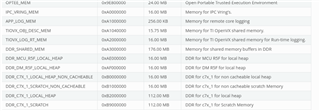

    We intend to run two pipelines of RGB and IR cameras with a resolution of 2592x1944 on our custom board, as well as the DMS (Driver Monitoring System) algorithm. Now, we want to know if 1GB DDR memory will be sufficient to meet the requirements.
   The system's reserved memory, which is referred to as the Memory Map in firmware-builder-user-guide, amounts to over 600MB.
   So we would like to reconfigure the parameters.We reduce the DDR_C7X_1_LOCAL_HEAP and DDR_C7X_1_SCRATCH to 50MB. But when we reduced the DDR_SHARED_MEM from 178MB to 50MB, the gst pipeline encountered memory allocation errors. Then we made some experiments , the details as followed:

Above all, we have the following questions:
  1. Is the dma_buf used by the gst isp plugin allocated from DDR_SHARED_MEM?
  2. If so, should the minimum DDR_SHARED_MEM for this camera pipeline be 53.3M?
  3. Could you provide some suggestions on how to reduce the reserve memory usage while algorithms and pipelines runs successfully
  4. Or could you provide some suggestions on how to run algorithms and pipelines on 1GB DDR memory?
