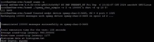

AM6442: Communication Latency Issues between A53 and R5 in a Linux-RT System
Part Number: AM6442
Downloaded TI's Linux kernel from the following URL and switched to the ti-rt-linux6.6.y-cicd version, using the RT (real-time) version of the Linux kernel.
https://git.ti.com/cgit/ti-linux-kernel/ti-linux-kernel/
Using the following example code from rpmsg_char_simple.c

Tested more than 100,000 times and set the priority with the command ./rpmsg_char_simple -r 2 -n 100000 & chrt -f -p 10 $!. The test results are shown in the following figure:
From the figure, it can be seen that the maximum latency is 1177us, which is too high and does not meet our current requirements. Is there room for optimization?

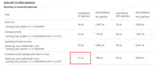

    No. If you are really trying to get a feel for longer term behavior, I would try running for on the order of millions or billions of runs. With that said, don't run tests yet - I want to talk about your results.
    I have since learned that the priority should really be placed above 50. -p 80 or -p 98 have been suggested to me as good settings for future tests.

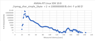

    Your results are very different from mine - let's figure out why
    Even when I was using stress-ng to add a bunch of background load on the A53 cores, I saw an average latency of 30-35 usec over 3 billion iterations, and the latency went over 1msec only 2 times. Your average latency is about 30x worse: https://e2e.ti.com/support/processors-group/processors/f/processors-forum/1388960/sk-am64b-rpmsg-between-a53-and-r5-performance-update/5328241#5328241

    Currently, the CPU is running at a frequency of 1 GHz. I am using the following file system.
    By default, the file system is placed on an SD card for operation. There are only the system's default tasks, no other tasks.. After the system starts, I run the following task:.
    I am not sure if my operating environment is the same as yours?

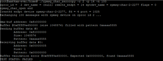

    I tested the rpmsg_char_zerocopy example using the command (./rpmsg_char_zerocopy -r 2 -n 100,) and the following issue occurred.
    When using the command (./rpmsg_char_zerocopy -r 2 -p 14 -n 100), the following error occurred. Could you please advise on how to correctly set the remote_endpt parameter and explain why the error messages in the screenshot appear?

    Summary: the zerocopy code is not getting loaded into the R5F core. I think you are still loading the default RPMsg Echo firmware.
    Details
    For remoteproc IDs, please refer to this file:
    https://git.ti.com/cgit/rpmsg/ti-rpmsg-char/tree/include/rproc_id.h
    I tested last week with this command which worked fine (where I modified 0xa500_0000 in the Linux devicetree file to be my shared memory region):
    ./rpmsg_char_zerocopy -r 2 -n 100 -e /dev/dma_heap/carveout_ipc-memories@a5000000
    -r 2 refers to R5F0_0, which should work fine if you have the correct firmware loaded and running on R5F0_0
    16 is the RPMsg endpoint number defined in the R5F firmware:
    https://git.ti.com/cgit/rpmsg/rpmsg_char_zerocopy/tree/rtos/ipc_rpmsg_zerocopy.c#n60
    On the other hand, 13 & 14 are the RPMsg endpoints that are defined in the default RPMsg Echo firmware.

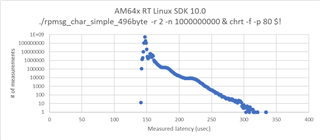

    Initial test results
    With the understanding that I have NOT optimized the filesystem and Linux kernel, this is about as good as RPMsg performance gets with the out-of-the-box default filesystem. Adding shared memory reads and writes will add more latency. If these numbers are not good enough for your usecase, you would need to evaluate other methods of signaling between Linux and the R5F.
    The latency to send 1 byte over RPMsg is much shorter than the latency to send 496 bytes over RPMsg. The test that is 1 billion iterations of sending 496 bytes is still running as I type this, but I will add the results as soon as the test finishes.

    The below tests were run like this:
    talk to R5F0_0. run the 1 byte test 1 billion times, and increase the priority above 50 and below 99
    ./rpmsg_char_simple_1byte -r 2 -n 1000000000 & chrt -f -p 80 $!
    Another potential test would be to add a background load on Linux. In that case, the command would look like
    stress-ng --cpu-method=all -c 4 & ./rpmsg_char_simple_1byte -r 2 -n 1000000000 & chrt -f -p 80 $!
    Gut check: tests with 10,000 iterations
    Test Avg latency worst latency
    ./rpmsg_char_simple_1byte -r 2 -n 10000 & chrt -f -p 80 $! 28 usec 205 usec
    ./rpmsg_char_simple_496byte -r 2 -n 10000 & chrt -f -p 80 $! 147 usec 257 usec
    Did not plot the histograms for these tests
    Tests with 1 billion iterations
    ./rpmsg_char_simple_1byte -r 2 -n 1000000000 & chrt -f -p 80 $! 28 usec 203 usec
    ./rpmsg_char_simple_496byte -r 2 -n 1000000000 & chrt -f -p 80 $! 147 usec 334 usec
    Test histogram

  • Hi Nick:
    I have tested the rpmsg_char_zerocopy example, sending 4096 bytes of data from the A53 core to the R5F core, and then having the R5F core return 4096 bytes back to the A53 core. The maximum round-trip time is around 350 microseconds, which basically meets our requirements. I have a question: what is the difference between the rpmsg_char_zerocopy example and the rpmsg_char_simple example? Could you illustrate their principles?
    Mack
